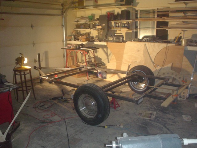

Postby Juneaudave » Sun Oct 01, 2006 1:20 pm
Big weekend for me. Got from here....
to here...

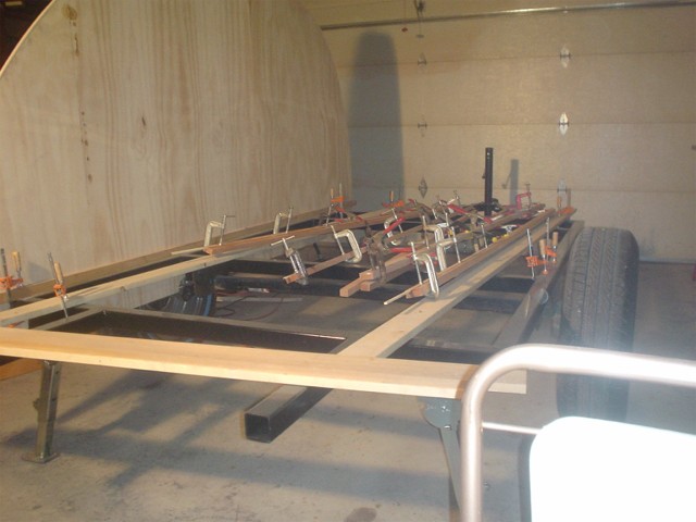

Postby Juneaudave » Wed Oct 04, 2006 12:31 am
Now I'm moving into the "clamp farm" stage. Got a nice crop going for whatever I'm up to....
