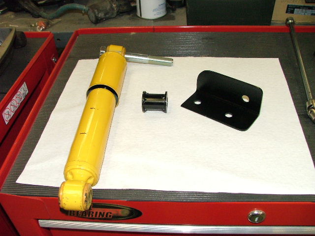

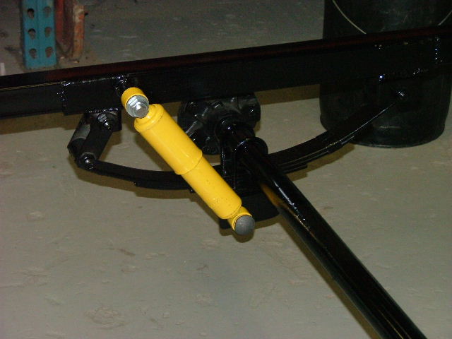

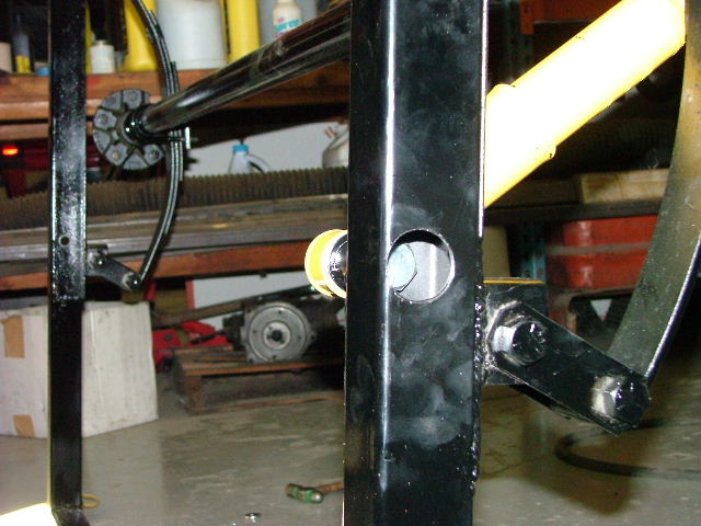

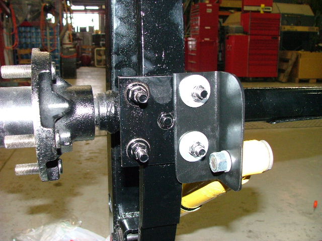

Postby WarPony » Sun Apr 01, 2007 8:24 am
Here's what I did:

Postby brian_bp » Thu Apr 05, 2007 7:32 pm
WarPony, I like the bottom bracket, and I understand the logic of the top mount, but I think I would rather do as the Monroe kit does (the one I used on my trailer) and run the top bolt right through the frame, needing only a 1/2" hole in each side rather than that huge head-clearance hole on the outside. I realize that there's a reinforcing plate on the frame, but it wouldn't be needed with the through-bolt. Was having the head exposed on the outside of the frame rail a problem, perhaps for body overhang?

Postby WarPony » Thu Apr 05, 2007 10:17 pm
brian_bp wrote: Was having the head exposed on the outside of the frame rail a problem, perhaps for body overhang?
Yep, the outside of the body lays RIGHT against the frame so there was no room for a bolt head. I'm not worried about water getting into the hole either because each end of the frame (side rails only) is not capped off. Thanks for the comps on the lower shock mount......... I stole it from Gerdo, though.

Postby brian_bp » Mon Apr 09, 2007 6:07 pm
Yep, the outside of the body lays RIGHT against the frame so there was no room for a bolt head...
There's always a reason for every design decision...
A slight refinement might be to use a socket-head bolt, which normally has a smaller head and does not need socket clearance around it, to minimize the size of the required clearance hole.
