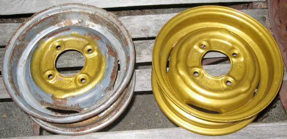

Since I had the resources for this test already created. And not worth selling.
I thought it'd be interesting to see how long it'd take for the painted wheel rim to start rusting. To give me some idea how long a similarly painted trailer chassis would last before turning to a 4 letter swear word.
I stripped all the rust I could from it using a wire brush attached to my electric drill. FWIW I removed the dust left behind, with tap water. It was then left to dry for a week, before receiving 3 coats of Hammerite.
[img]http://i135.photobucket.com/albums/q135/muggnz/rusty/10-2.jpg[[img]img]
The rims are currently resting on a bench in my back yard, exposed to worst the weather can do.
The paint is already dry, so if you like watching it dry, this probably isn't for you.

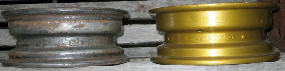

Postby Muggnz » Sun Sep 16, 2007 4:19 am
A week late :x
however the pix were taken on the 3 month anniversary.
The growth on the unpainted rim continues.

Postby angib » Sun Sep 16, 2007 12:21 pm
It look as though you may have got the start of some new rust appearing - in the join between the rim and the wheel centre?
I had the 30-year-old steel wheels of my Morris Minor grit-blasted and epoxy coated and they just started to discolour in that very spot after a couple of years.
There really is no way to get the metal clean right into the joint between the two parts, so one day the rust will come back there.
Andrew

Postby Muggnz » Tue Sep 18, 2007 4:11 am
The join between the rim and the wheel centre seems ok. It is however, covered by the old ( original? ) paint.
So far it looks like the rim will fail first, as it's paint has vanished.

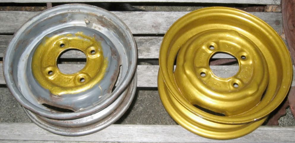

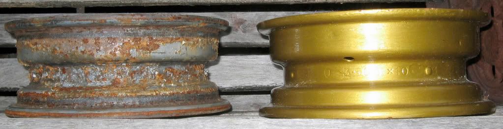

Postby Muggnz » Sun Dec 16, 2007 2:56 am
the latest pix have made it thru my system
