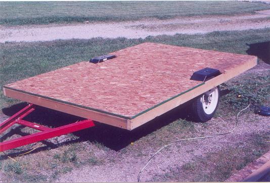

Postby forestfrog » Wed Aug 08, 2007 12:21 am
I'm building a 5'x8' on a 4'x8' HF frame (12" wheels). The wheel wells only extend up into the cabin by about 2.5"...that plus the thickness of the floor/supports gives 4.5" of clearance to the tires (factory fender clearance is 3.5" on the trailer I have). I'm using an 8" foam mattress, so I just cut a shallow piece out of the bottom of the mattress over the wheel wells...the mattress lays perfectly flat wall to wall and you can't even tell the wheel wells are there.
I don't have a current interior pic, but here are a couple of construction pics showing the wheel wells:
Kristi

I coppied Cristie's wheel wells but mine came out a little taller.
Skipper
