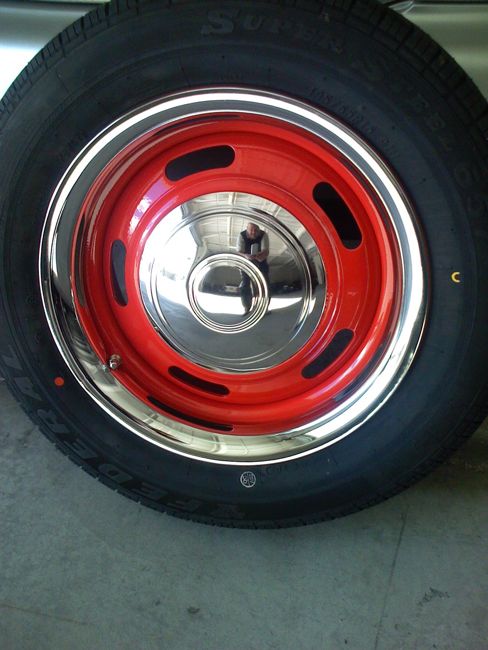

Postby GregB » Wed Jan 30, 2008 3:14 pm
I'm using these 15" with a HF frame but then I realized that with 0 offset, they would rub against the frame. I replaced the axle and added a couple inches for looks and so I can have easily replaceable bearings. The axle was only about $110 locally. I ordered the tires and wheels at a Les Schwab and they did the powdercoating for me as well.
GB
I'm not dead, yet. I'm feeling better.
GregB
Posts: 528
Images: 108
Joined: Thu Sep 29, 2005 2:22 pm
Location: UT, Lehi
Postby TPMcGinty » Wed Jan 30, 2008 6:39 pm
GregB wrote:Image
GB
GB, Nice looking wheels! Very classy!
Tim
