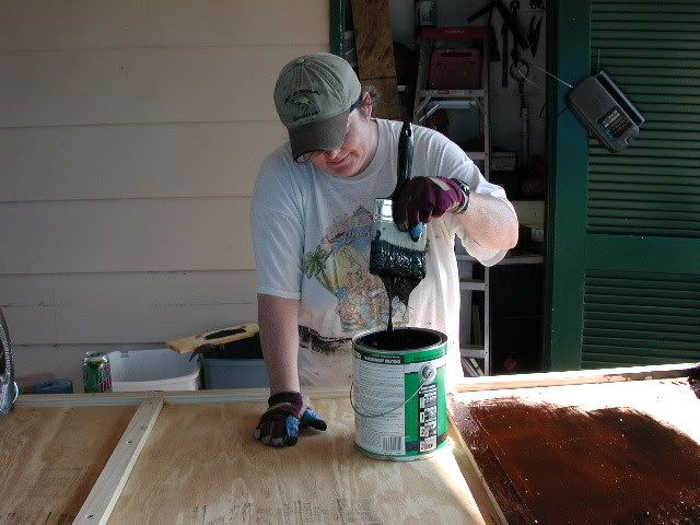

Postby Mary K » Sat May 03, 2008 10:12 pm
Ah,...the good old days.......
That fence post paint looks good also. :thumbsup:
