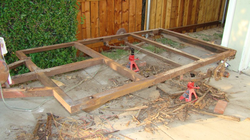

well guys i spent all this week taking off the rust off the top of my frame where the floor is attached. the only problem is that fortunetly the frame is so thick and i got to it before it could do alot of damage. there are some areas where some of the frame was being eatin by the rust, you can tell a few specks on it but nothing major. i was wondering if some areas that i grind off the rust but there is still some left and i decide to place primer on it, will it still do its damage? also i got most of the rust off with a grinding wheel and a wround wire brush like i said most of it came off. now i do have a sand blaster on the way so i do plan on using the sand blaster but im just wondering in case i dont get all the complete rust off and only some specs are left what would happend on the long run.
:worship: can any one help please?
http://tnttt.com/album_ ... c_id=37438
the curb side part of the frame behind the wheel is where it was being eatin the worst buts its not bad enough to panic i hope

For what it's worth...surface rust isn't so bad, clean it up, prime and paint. If it shows some serious cancer in the steel, that might need to be ground out and taken care of or carefully checked. I'd check the welds to make sure they are complete and no holes left that would allow water to enter the tubing, if there is any, especially if there is no way for it to get out. Looks like it's constructed in angle. It all appears like just surface rust to me.
Do you have any idea on where it spent most of it's life? Kinda looks like it was never painted, pretty evenly rusted all over, but that might be due to your efforts. Since you're in Ca. (relatively dry climate) I'd just get it off and prime and paint if it's in good condition. Wipe it down with lacquer thinner before priming. I'd shoot a good epoxy primer on it too. Another option is Por 15 makes a great primer that will go over rusted materials. If it spent it's entire life on the coast....I'd check it out closer, salt is really tough on iron. Just my 2 cents worth. Others may have varying opinions. Doug

well the thing is it spent 14 years in the back yard of my uncle and he lived in chino california up to his death last year.it all is mainly surface rust, the welding parts look ok but i havent checked the bottome part. on the curbside wheel area it looked like it was being eating but its not to bad, i grinded it off and wire brushed it and most of the rust came off. im gonna try the sand blaster and see how that goes i hope its not damaged too much and if it is i can always have someone weld a new piece to it right? ill get soem close up pictures of the bad area tommorow

I wouldn't sweat it...you're going to be OK...Looks like a solid frame, just needs some attention and a good paint job. Chino is pretty dry, rust is rust...rot is something else. If you decide to blast depending on how much air CFM you have behind it, cover the hubs with something and don't hit them, especially where the hub seals on the axle.... ....Doug

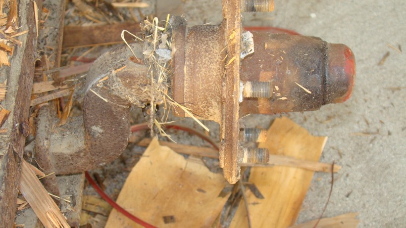

WHAT ARE THE HUBS AND WHERE ARE THEY LOCATED?I CAN GRID THE AXLE PARTS WITH THE GRINDER WHEEL. HOWMUCH AIR CFM WOULD I NEED AND CAN I GET THE SAND AT HOME DEPOT?

TD_Dodger wrote:WHAT ARE THE HUBS AND WHERE ARE THEY LOCATED?I CAN GRID THE AXLE PARTS WITH THE GRINDER WHEEL. HOWMUCH AIR CFM WOULD I NEED AND CAN I GET THE SAND AT HOME DEPOT?
These are your hubs. As Doug mentioned, you want to avoid blasting any sand inside them. It will destroy the bearings.

THANK YOU SIR SO ILL HAVE TO GRIND THESE WITH THE WIRE WHEEL.

You'll probably want to pull the hubs and check the bearings and regrease anyway. While it's apart just clean up your axle stubs and wrap them up with duct tape and a rag and don't blast directly on them. If you have a small home type blaster like I do, it's pretty touchy on just using HD play sand in it. I can only do small parts I usually get a bag of good screened media. If it's more of an industrial type blaster with a large diameter nozzle, it can handle the play sand. Doug
