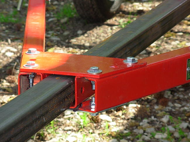

I absolutely could not 'abide' the clunky HF tongue arrangement, especially the coupler. I removed the coupler, did a little judicious grinding on the ends of the 'A-frame' members, turned the coupler mount upside down, slid a length of 2X2X1/4" square tubing thru the coupler mount back to second cross member, bolted on a couple of pieces of 1 1/2" angle either side of the square tube, between the first & second cross member, bolted the new tongue to the angles & to the old coupler mount, & 'voila' a new, much more sturdy tongue on which to mount a new coupler. It extended my tongue length by around 14" or so which makes backing easier. I also moved the axle rearward about 4-6" so my hitch weight is approaching 15% (about 135-140lbs) with the tongue box but my little P/U tow vehicle handles it very well with no rear 'sag' & even my wife's Santa Fe does OK with only a minimal 'drop' when the TD is hitched up. Also replaced the pins of the 'tilt' feature with automotive strength bolts on the 'A-frame' pieces which decreased the 'flex' of the tongue & eliminated the 'rattle' associated with that when on rough/bumpy roads ;)

Nobody wrote:I absolutely could not 'abide' the clunky HF tongue arrangement, especially the coupler. I removed the coupler, did a little judicious grinding on the ends of the 'A-frame' members, turned the coupler mount upside down, slid a length of 2X2X1/4" square tubing thru the coupler mount back to second cross member, bolted on a couple of pieces of 1 1/2" angle either side of the square tube, between the first & second cross member, bolted the new tongue to the angles & to the old coupler mount, & 'voila' a new, much more sturdy tongue on which to mount a new coupler. It extended my tongue length by around 14" or so which makes backing easier. I also moved the axle rearward about 4-6" so my hitch weight is approaching 15% (about 135-140lbs) with the tongue box but my little P/U tow vehicle handles it very well with no rear 'sag' & even my wife's Santa Fe does OK with only a minimal 'drop' when the TD is hitched up. Also replaced the pins of the 'tilt' feature with automotive strength bolts on the 'A-frame' pieces which decreased the 'flex' of the tongue & eliminated the 'rattle' associated with that when on rough/bumpy roads ;)
Thanks Harvey ! That is exactly what I feel needs to be done and a beautiful job of doing it . I am gonna steal your pics if you don't mind for reference on retrofitting my tongue repair.
