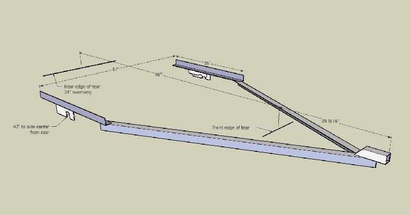

Postby tinksdad » Wed Nov 26, 2008 12:06 am
Well..... I'm committed now. Went to Northern Tool and they had one in stock on sale. With my 15% off coupon, it came to $155 with tax.
The 57" inch width will work just fine for me. It leaves me plenty of room to get a 54" full mattress in (not quite a queen; but still 19" more than I have now). I didn't get hubs yet because I'm going to look at some wheels in different sizes before if I decide on 4on 4 or 5 on 4 1/2.
I tweaked the design a little to work with the 6 foot lengths of angle I can find locally and to fit the 57" width. I think this should work, although I will have to find a way to disguise the additional 12" I will have to add to the axle mount pieces. If I can find a supplier of longer lengths, I will revert to the shorter side mounts and longer tongue pieces. Either way I think I will add a piece of flat stock across the top of the tongue under the front edge of the tear to compensate for the thickness of the angle walls.
The axle, steel, hubs and wheels should come in right about 150 pounds. It should handle the 500 pounds of tear that I will build on it.
tinksdad
Posts: 966
Images: 155
Location: Olive Branch, MS
Postby angib » Wed Nov 26, 2008 9:52 am
That looks good.
One issue is that the plans I drew showed 40" from the back of the body to the axle tube, but that was using a Dexter #8 axle that has 4" long trailing arms.
The 2000lb Reliable has 6" long trailing arms, so that will put the wheels 2" further back, if the axle tube is kept in the same place. 2" is pretty close to "don't matter" but if you wanted to keep the wheels in the same place, and hence the same trailer balance, the Reliable axle needs to be mounted 2" further forward.
Andrew
