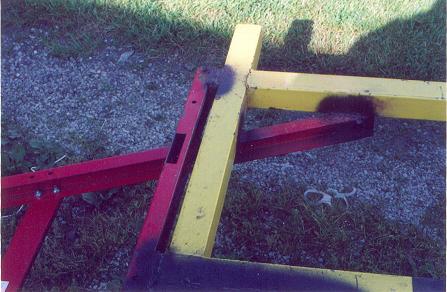

Postby bobhenry » Fri Feb 13, 2009 2:04 am
racerjmh wrote:Anyone ever do this? Buy this HF trailer for the stuff and then build your own 4x8 frame? http://www.harborfreight.com/cpi/ctaf/displayitem.taf?Itemnumber=90153
Jim Harden
YEP !
More pics in my album page 16 & 17.
And yes it is sections of a junk handrail
Although have pulled my little trailer 4,00 - 5,000 miles I am not happy with the tongue and intend to make this repair this summer.
A borrowed this pic off of a fellow forum member for reference later and would like to thank him.
