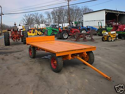

I've been thinking about using this type trailer for a gypsy caravan build. What modifications would it need and does anyone out there have experience towing a steerable trailer at highway speeds? The photo below is a trailer about 67" wide and 144" long.

Steve_Cox wrote:I've been thinking about using this type trailer for a gypsy caravan build. What modifications would it need and does anyone out there have experience towing a steerable trailer at highway speeds? The photo below is a trailer about 67" wide and 144" long.
We had an old in line 2 horse trailer with a steering axle back when I was a teen. Wheel balance and front end alignment are important, just as it is on the tow vehicle. It pulled fine gong forward (speed limit was 70), almost impossible to back up except with a tractor, somehow it was easier if you could look down and see the tongue (at least when I was in my teens). But it was easy to push backward by hand. We also had a hay wagon with steering axle but it was not intended for highway speeds. One advantage is that they have very little tongue weight, only the actual weight of the tongue resting on the hitch. They are easy to hook up because the tongue is free to swing right and left and unless chocked on an incline you can move the whole trailer rather easily.
I have a small utility trailer for my lawn mower with the steering axle. I like that it can be unhooked form the tractor and remain level while loaded with no problems. It has been a constant source of amusement trying to back that thing up with the John Deere, maybe this was easier when I was yonger, at least my wife gets a good laugh.............. :lol: :lol:

Postby Nitetimes » Thu Mar 05, 2009 10:58 pm
I think I'd want to make sure the steering joints were all in very good condition. Just a little slop would probably make that very squirrelly on the highway.
Another thing that might make me scratch my head would be brakes on the front axle of that, in PA it would be required, I think whoaing it in a hurry would tend to make the front axle do a jig.
I've seen lots of farm wagons on the road around here and most of them keep it under 40 or they get to swingin'.
Just a couple of thoughts. You did ask.

Postby mk10108 » Thu Mar 05, 2009 11:12 pm
dont do it. :thumbdown:
Made for low speed and manuverability

Postby Steve_Cox » Fri Mar 06, 2009 7:28 am
Nitetimes wrote:I think I'd want to make sure the steering joints were all in very good condition. Just a little slop would probably make that very squirrelly on the highway.
Thanks for the thoughts on the subject Rich. As far as the steering, there are a couple of types that are used on the road commercially, and I know there are lots of small commercial trailers like that in Europe. Guess a trip over to check them out might be a good idea 8)
mk10108 wrote:dont do it. :thumbdown:
Some are, and some aren't. Lots of tandem tractor trailers on the highway, and they don't go slow 8)
Got one of these " :thumbdown: " Now I know for sure I want to build it. Wonder why that is? :lol:

Postby Nitetimes » Fri Mar 06, 2009 10:38 am
Steve_Cox wrote:
Outside the Box thinking: I wonder how a small 5th wheel receiver would work mounted on car dolly :thinking: :lol:
That is something you have to be very careful with. The tongue, unit mount either has to be very stiff and well braced or it needs a 4 wheel carriage. The problem with it is the 5th wheel plate will move for and aft in stops and starts, could cause lots of handling problems. The other thing to think about....ever follow a tandem or triple trailer rig? They tend to snake quite a bit. If your on a less than flat road the tow unit and trailer are going to want to run to the low sides of the road so I'd say pulling with anything less than a full size pickup is gonna put a lot of stress on the tow vehicle.
I have seen this setup advertised several times and don't care for it, too many variables that can't really be controlled for it to work well.
Also a lot of added weight to drag.
I build four wheeled steering trailers occasionally for the place I used to work and they are never rated for more than 35mph, I've done some test pulls with them and 35 is right on the edge of the trailer whipping all over the place and when you hit the brakes at that speed you can see the trailer trying to head for one side or the other.
I wouldn't tell you not to do either one but I certainly wouldn't recommend them either, particularly if you want to get on any interstates.
Just some food for thought.....
