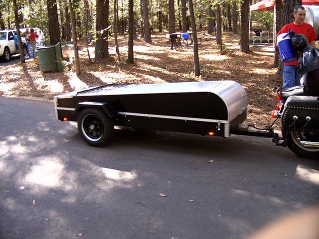

Vic, welcome to the playground! There are as many ideas about motorcycle trailers as there are about teardrops, so you'll have to make a lot of choices. I pull a homebuilt sleeper with my '00 Softail Nightrain. My choices: I use 12" tires on 425# UFC half axles (I'd use lighter if any were available). Adjustment is good, but not cheap. My trailer body is 33" wide, which gives me an overall width of 46". I can't advise on tongue length, 'cause I've had to experiment with both tongue length and axle placement to get a good ride (there's nothing more uncomfortable than trailer wiggle at 60 mph!) Forget the swivel hitch unless you plan to lay it down or ride it upside down. A regular ball works fine.

Just about any size of trailer tire will have enough load capacity, so I think this comes down to ride/handling and appearance. With a Harley tug, I have to think that bigger will look better; to me, B52's trailer looks good and would not look as good with 8" wheels.
