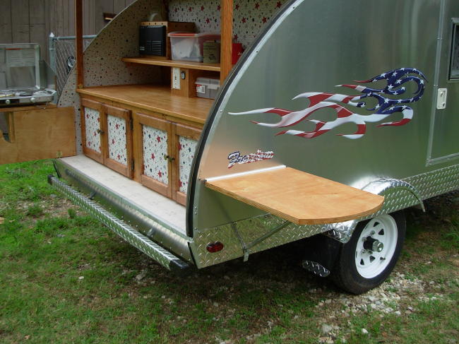

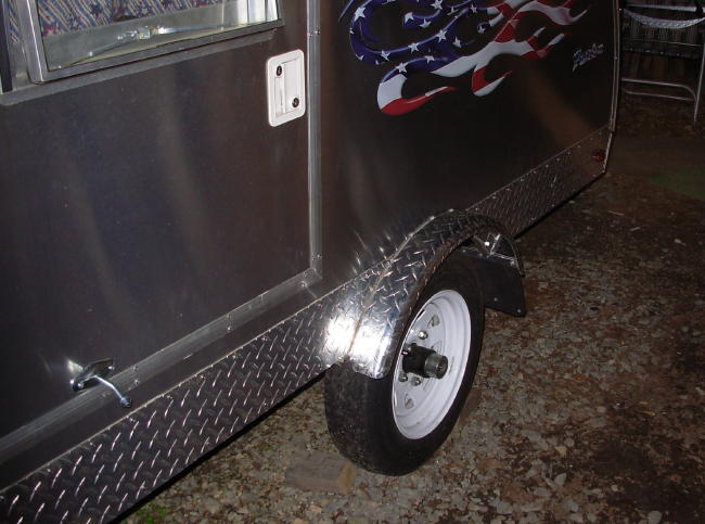

That's the way I did mine Arne. Used a diamond tread fender from Northern Tool; split it lengthwise & cut to length for my 12" wheels/tires then modified each piece to fasten to the body. Ended up with about 2 1/2" fenders (flares?) at each wheel well opening. Used it like that for a while but then took the diamond tread 'cut outs' that came from the lower trim when I cut the wheel well openings & fastened them to the fenders as a sorta 'skirt'. The fenders & skirts improved the entire look IMO.

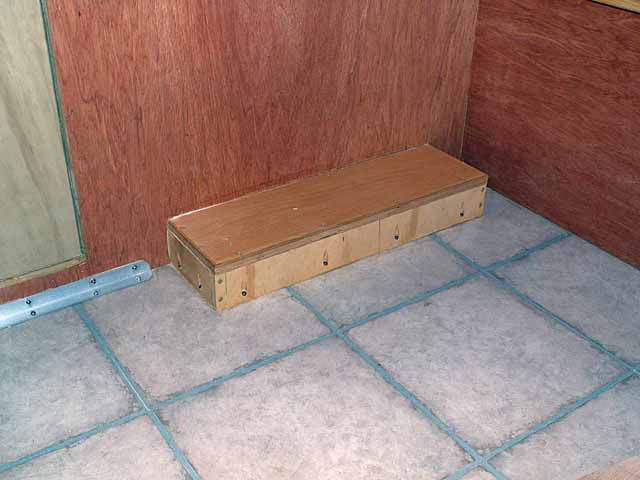

Postby Nobody » Wed Apr 08, 2009 9:27 am

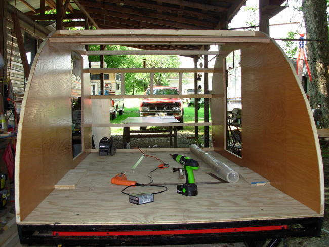

Like Steve F I wanted to 'match' the track of my tow vehicle(s) so I selected the HF 1740# trailer. I also wanted a 5' wide so that required building over the wheels. I built my floor frame of 1 3/4 X 1 1/2" (ripped spruce 2X4's) set with the 1 3/4" side vertical. My wheel wells provide approx 2" of vertical clearance above the tires & intrude only a little over an inch vertically into the cabin (using a 4" memory foam mattress with a 1 1/2" memory foam topper we never even know they're there). I've since added a 1" thick steel 'spacer' between the spring & the axle seat to provide additional clearance when off-roading or carrying more 'stuff' in the TD. Never had any contact between the tire & wheel well but springs do have a tendency to 'sag' over time & I thought, "better safe than sorry." ;)
Floor being 'framed out'
Bottom of floor (& wheel wells) after being asphalt coated & insulation installed
This is how much the wheel wells intrude into the cabin. The galley/cabin bulkhead was installed at the very rear of the wheel wells
