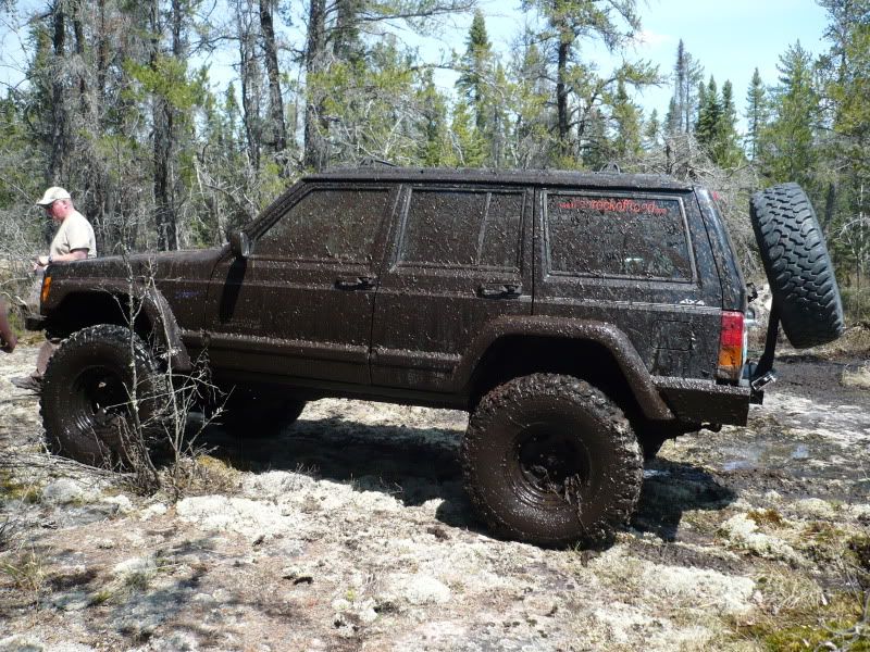

The jeep is a bit muddy in the photo but this is the most current photo.

It looks like you went muddin in the Labrea Tar Pits! :shock:

it looks worse than it was, I live in Manitoba not to far from the edge of the canadian shield which is all rock with thousands of lakes and more than a few swampy areas, I had just finished pushing a stuck friend out when I got stuck myself so for the photo op I put the throttle down knowing what the result would be. About a mile from that spot is a real nice camping location for a tiny off road travel trailer :D its fairly secluded and you can find peace and quiet there. Actually I guess this is the wrong spot for this topic, I will put further pic,s etc in the off road section.
