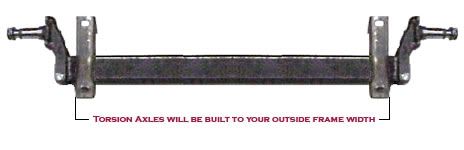

So, if I wanted to build a basic 4 x 8 TD, and wanted to use a torsion axle, how would I determine axle length? :thinking:

I figured it out. If I use a torsion axle, I will want the width of the axle to be the same as the outside frame width. So, a 48 inch wide frame would need a 48 inch torsion axle.

...Chan, I am afraid it is not so simple...there is some excellent info located in the stickies in this section of the forum...you will need 3 different measurments to accurately order an axle...outside2outside frame, which will determine where the MOUNTING PADS sit...outside2outside hub measurments, which will be determined according to what wheels you use...this is probably your MOST important measurment and if you want the body to come down over the frame, you will need to determine inside2inside measurments for the torsion arms...not taking these things into consideration may well cause you to end up with something you don't want and possibly can't use...........

I like to see the tire centered in the width of the fender. If the clearance seems too tight, then maybe you're using too wide of a tire/rim. You need to have your tires and rims before you order the axle as different rims have different offsets (where the mounting surface (rim to hub) is in relation to the center of the tire.
Step one: obtain rims and tires
Step two: determine center distance for spring/torsion mounts
Step three: determine outside hub to outside hub distance to make sure the tires end up in the center of the fender (or where ever YOU want them to be).

Here is what I learned from doing mine:
Yes I had to notch my body, it wasn't that big of a deal.
I had 2in clearance between the tire and sidewall, too much IMHO (1/2in would be fine).
Have your wheels with the tires mounted so that you can find your exact offset.
See if a "short spindle" is available and order it if possible.
Step 1 Get your tires mounted to the wheels you want to use
Step2 Lay the wheel on the ground and measure the distance from the floor to the hub face.
Step3 Tire Offset X2 + sidewall to tire clearance X2 + body width = hub to hub distance.
