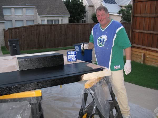

I used Henry's asphalt roof coating. (note the product placement :lol: )
ImageMark (& Cindi)
