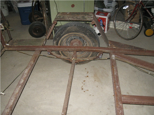

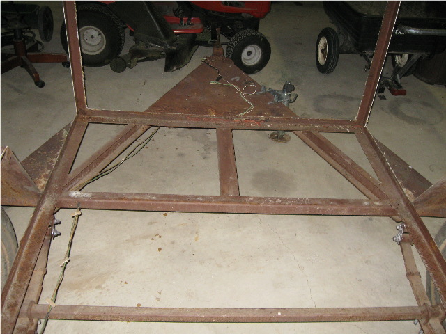

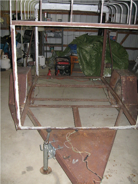

OK here is what I have. The trailer is over all length of 10' 6" including the tounge. the box is 7' X 5'. the box frame is made of 2"X 3" angle that has a few years on it.
What I am thinking, is that I want to do is build a 10' X 5' tear. I was going to just sister up some longer angle and get the length that I need but with the axle placement now that will have to be moved and you might be able to see there is a slight bow right above the axle.
I was thinking that the best bet might be to build a 10X5 rear frame and then just reuse the axle and tounge.
Does any one see any problems with this or advice?
What type of steel would you recomend tube, angle, c channel?
Any way thats where I am, and I respect any and all comments
Terry

I looked at your pictures before I read your posting. I came up with the same idea you did. Reuse the tounge and axle assemble. Build a new frame out of new box or channel. You might be able to reuse some of the old angle for crossmembers.

The angle is strong enough for putting a rigid body on, but being bent like that, no, or an exercise in frustration. You need to straiten it first, the easiest way replacement, Save the tongue, paper work, and axle.
You may want to get springs that match the tears gross weight, those look too heavy (I know they have been overloaded, but not with a tear on top).
Now for thickness 1/4 too heavy, 3/16 heavy, 1/8 will get the job done if securely mounted to the body.

I am a fan of 2x2 tubing, replace the side rails with that and maybe a couple of cross pieces also and clean up and reuse the rest. Also older Jeeps had the front spring shackles mounted like your trailer with the shackle to the front, it was notorious for a rough ride, turn the set up around ie have the shackle to the rear and it will give a smoother ride IMHO.

Except for the bowing over the springs; I would have said keep the angle. It's been overloaded. With the healthy coat of rust hiding any fatigue; I wouldn't use it. Save the tongue and axle. Stay on the safe side

Just a question, are the spring hangers on backwards in the first photo?

Nope, the assembly you are looking at will go on the left side of the trailer. The side that will go on the right side is a mirror image of the assembly pictured. For the best ride the shackels should be mounted on the rear of the springs.
