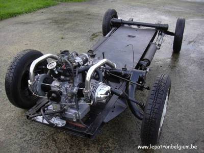

Postby john » Sat Oct 24, 2009 10:32 am
The 2cv (the little French car) had as its front suspension a reversed trailing arm setup. It was not unstable and the car as a whole was nearly impossible to roll over.(edit:Stolen from the net, and thanks to he who is labeled on the pic)

Postby fourays » Tue Oct 27, 2009 1:57 pm
john wrote:The 2cv (the little French car) had as its front suspension a reversed trailing arm setup. It was not unstable and the car as a whole was nearly impossible to roll over.(edit:Stolen from the net, and thanks to he who is labeled on the pic)
I had a couple of those growing up, however the there was a kingpin on the end of the arm that the wheel pivoted on. that put the contact point behind the pivot point leading it to caster.
