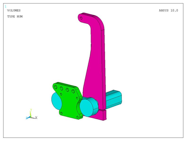

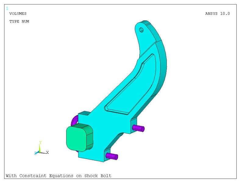

I gathered a good bit of information on air suspensions and discussed it with my brother-in-law, John, who is a mechanical engineer who has worked in aerospace (jet engines) and automotive, race car design and is an expert with one of the rather esoteric computer programs used for stress analysis. My experience includes failure analysis and non destructive testing including the space shuttle to carnival ride inspection.
To cut to the chase.

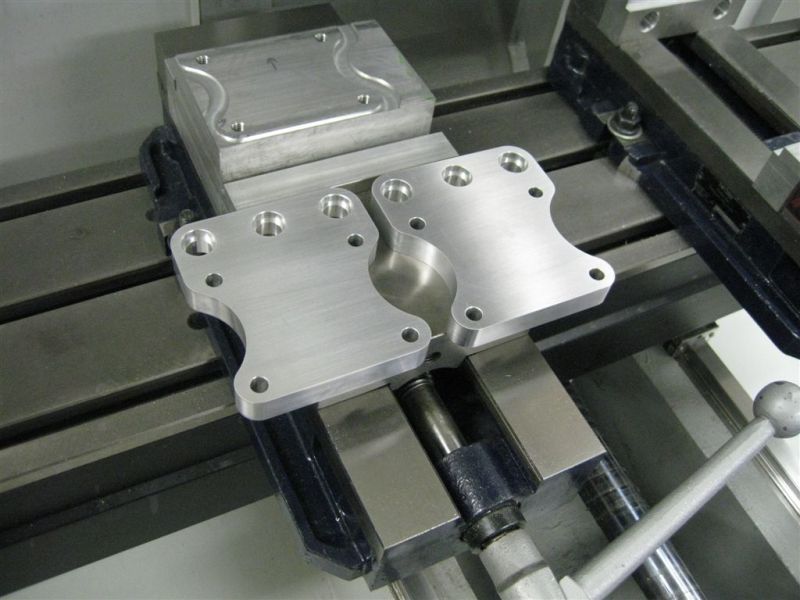

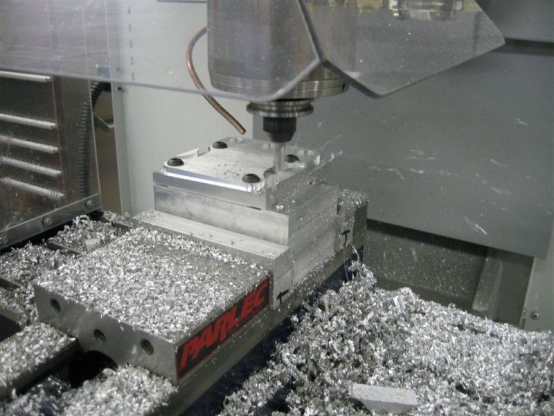

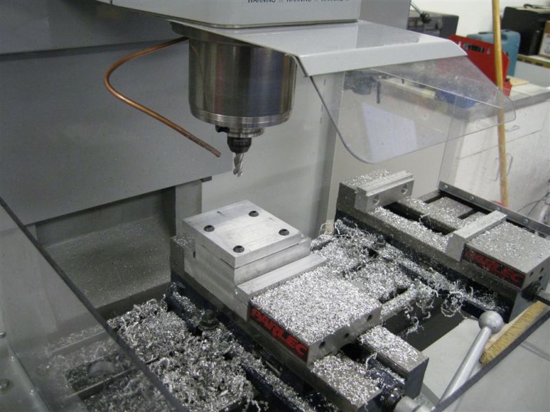

The design is finalized and work started on the prototype, the CNC is finished on the bracket attached to the arm and a pair machined out of aluminum. The prototype air shocks will be those used in a Corvette
early design, note final product has only three holes for mounting shock.

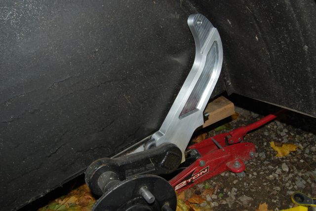

Shock support arm attached to axle final design
:roll:
Machining
Final bracket
This BTW is all being done in John's home work shop
:D

T) This mounts entirely on the Dexter Axle. Note that the curvature of the bracket follows very closely that of the axle tube and will be held on to the tube with a flat custom bent U bolt. the two brackets are held on with stock U bolts
"Looks like you are stiffining up the ride to me by pre loading the torsion arm. Would it not be as easy to raise and lower the entire torsion axle to change the ride height with a frame hinged assembly to mount the axle on?"
T) This unloads the Torflex placing the load on the air shocks. The additional air bag (as you describe) is the approach taken in Dexter's VERY heavy duty axle and yes you could, but again this adds levels of complication and height and weight. We wanted this to be a bolt on kit that any one could install on an existing trailer with no welding...
"Will there be enough clearance between the shock and tire/wheel given the spindle length of the Dexter?"
T) I can't tell you how many times I crawled under the MM and or took off a wheel to get exact measurements. I had to replace my digital caliper (dead after 20+years) to get dead on accuracy. The shock was carefully chosen and you can see the steps cut into the brackets to make it all fit.

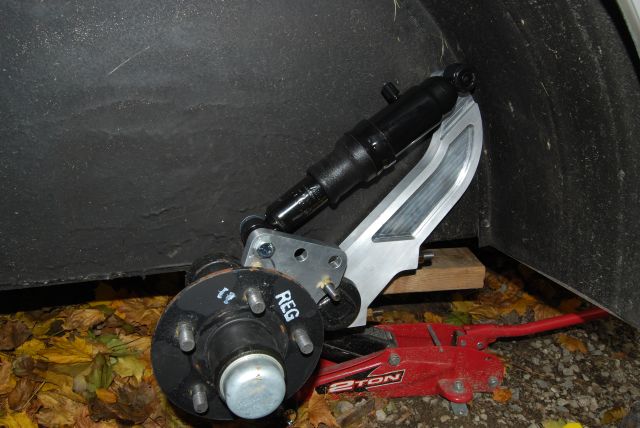

Final kit for testing
air bags

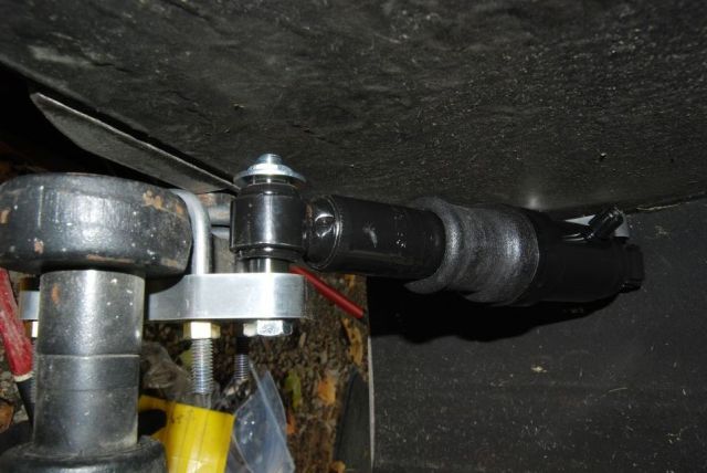

Postby Shadow Catcher » Thu Nov 05, 2009 5:58 pm
This is the first mounting. the U-Bolts need to be trimmed and I did not get the correct bolt for the attachment of the Shock to the upper bracket.
One major concern, I did not take into account the clearance when used with brakes, which the next MM will have.
Does any one know the clearance between the Torflex arm and the back of the brake plate?
Postby schaney » Fri Nov 06, 2009 11:38 am
Hmmm, no dimensions for the brakes in their catalog, the hyd brakes have a flat backing plate and the elec ones wrap around the backing plate. Try calling Dexter.
