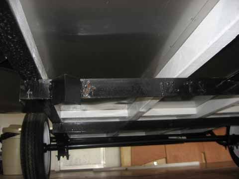

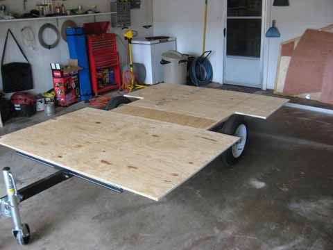

Postby starleen2 » Sat Nov 07, 2009 8:00 am
Here's my TSC 4X8 NF trailer frame
Floor: 5/8 inch plywood � very sturdy and no need for framing beyond the actual trailer it self. I used a sub frame constructed out of 2x3 s to support the camper floor over the trailer The underside of the floor is painted to seal the plywood. I applied sheet Aluminum to the underside of the floor to protect it from road debris and water spray. Bolted the entire structure to the trailer.
Completed flooring
