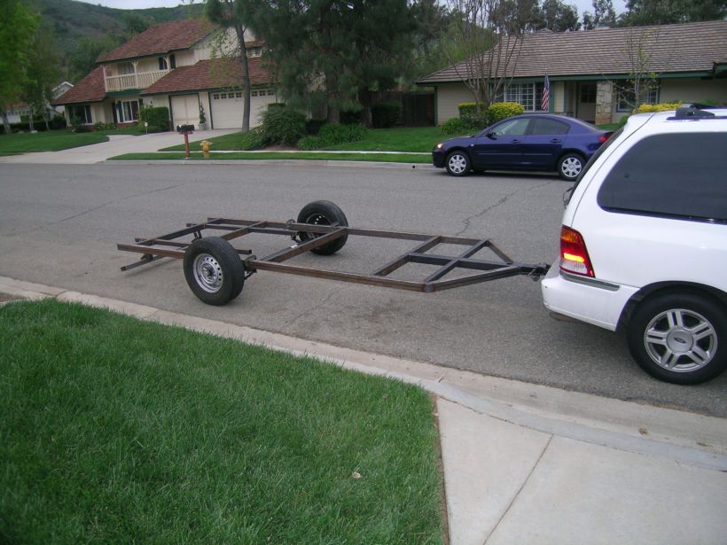

Postby bobhenry » Mon Dec 28, 2009 10:07 am
I really like the way this one was built that "c" channel will hold what ever is thrown at it !
Pretty sure it's Planovet's frame.
Postby planovet » Mon Dec 28, 2009 10:19 am
Yep, that's my frame. It's definitely a solid frame. Actually they overbuilt it but what could I do after the fact. They added some things that I didn't request because they thought I needed it. They had never built a trailer dedicated for a teardrop before. All in all it's a great frame and I'm glad how it turned out.
ImageMark (& Cindi)

Postby eamarquardt » Sat Jan 02, 2010 1:48 pm
Just noticed the request for a better picture of my tongue. Here it is. Hope this helps.
Cheers,
Gus
