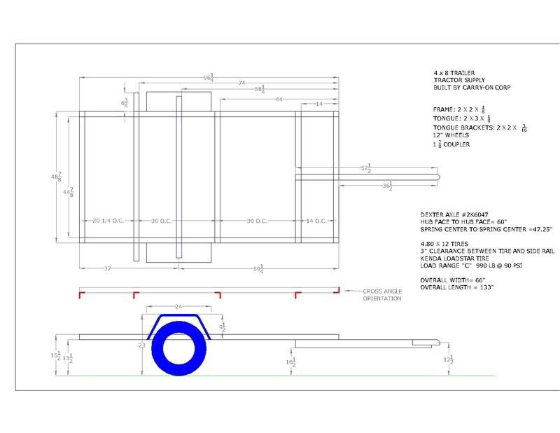

len19070 wrote:I like this frame.
http://www.tractorsupply.com/trailers-t ... wr-1000215

angib wrote:The Carry-On trailer from Tractor Supply is the one that has caused problems with weak tongue mounts to one or two forum members - the tongue itself is strong enough but the two angle cross-members it's bolted to are too close together and they can be bent by high tongue loads - in one case by the builder standing on the tongue.
Andrew
