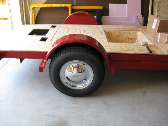

Postby planovet » Mon Sep 20, 2010 10:48 am
JIML1943 wrote:You might try here.
http://hubcapmike.com/rdc01-12.html
That's where I got my hubcaps :thumbsup:
ImageMark (& Cindi)
planovet
The Cat Man
Posts: 5583
Location: Plano, Texas
Postby emiller » Mon Sep 20, 2010 11:03 am
That is a nice looking wheel and tire combo Mark. :thumbsup:
