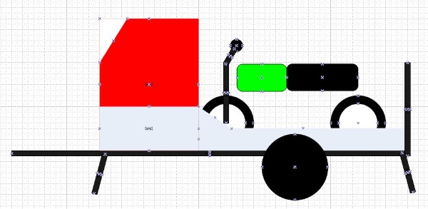

Here is a very crude side view drawing. The rear of the trailer is similar to a std utility trailer (5x8 plus a tailgate/loading ramp)
Front of the trailer is a reverse TD design like the Jim Dandy, which houses the outdoor kitchen and the storage. TD part of trailer will be 5' wide, 5' tall, and 5' deep.

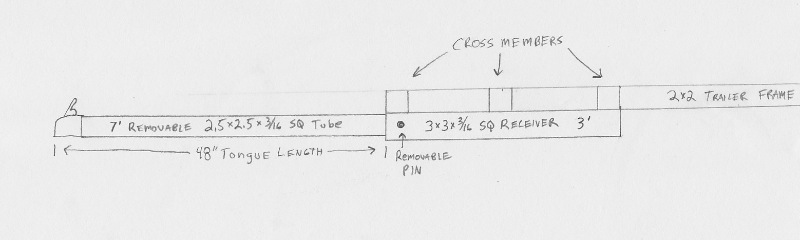

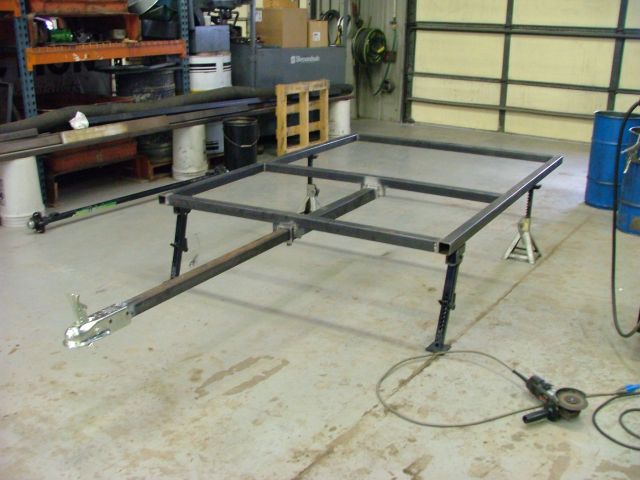

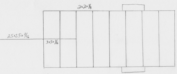

A key feature I need is to have a removable tongue...since the gallery area is up front. Here is a rough sketch of the frame I am building.
Frame is 12' x 5' and is constructed of 2x2x1/8 square tube. Cross members are spaced at roughly 18".
Idea for the removable tongue is to mount a 3 foot section of 3x3x3/16 tube to the first 3 cross members, then insert a 7 foot section of 2.5x2.5x3/16 tube inside of the 3x3 tube.
This design would allow me to slide the tongue under the trailer when I am using the Gallery.
I think the max weight of the loaded trailer will be just over 2,000 lbs.
I've stared at Andrew's tongue strength charts till my eyes hurt. :-)
Any and all advice is appreciated.
Thanks...David

Postby HometownHockeyFan » Mon Mar 28, 2011 7:29 pm
Chris,
Thanks for your reply.
That's pretty much what I'm thinking of doing, but using a 2.5x2.5x3/16" tongue going into a 3x3x3/16" 'receiver' tube. (Based on the reading I've done in Andrew's tongue strength guidance, I need to use something larger then a traditional 2" receiver)
I'd like to keep the design as simple as I can as long as it is strong enough.
Thanks...David

Postby HometownHockeyFan » Tue Mar 29, 2011 7:21 am
Thanks for the feedback!
Here is a crude drawing of my current concept.
When not in use, the 7' 2.5x2.5x3/16 SQ tube will slide back towards the axle so that only the hitch part of the tongue will be sticking out.
I think it will be strong enough...I'd feel better if I could use a Composite Tongue design...but, I don't see a way to do that and still make it easily removable.
Thanks...David

Postby eamarquardt » Tue Mar 29, 2011 10:53 am
HometownHockeyFan wrote:I think it will be strong enough...I'd feel better if I could use a Composite Tongue design...but, I don't see a way to do that and still make it easily removable.
Thanks...David
Think a bit differently. Your galley/storage box is going to be about 4 feet long and 5 feet wide. Why do you have to access it from the end? A four foot wide galley is very doable. Put storage on one side and the galley on the other side. Then there is no need to have a removable tongue with the attendant compromises. You could also then utilize the tongue area for a wedge shape box, improve your aerodynamics, and have more enclosed storage. You'd have plenty of frame right along side to mount a removable table (using receiver tubes under the frame), and maybe some other advantages to boot.
Not that I have any concrete data but I just think a single tube tongue on a trailer that will weigh 2K# or perhaps more is not the optimum design.
I'm not predicting disaster but the tubes will not be a snug fit with one another. In my experience, sloppy fits bang themselves to death over time and lead to problems. I think it would be "good form" to minimize the slop (if you go with a removable tongue) and make custom, snug fitting, receptacles/sockets for the tongue tube.

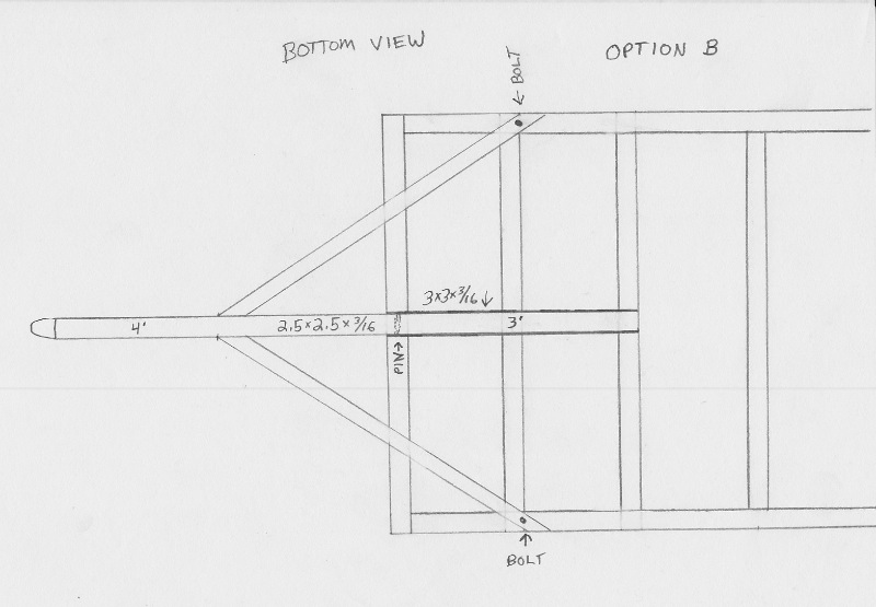

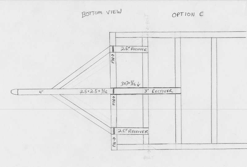

Here are two other options I've dreamed up that allow me to use a Composite Tongue, but still have it removable.
This does not look to hard to make, and I think it would add quite a bit of strength, and still be removable.
Option C
I like this option because it does not interfere with the stabilizers I plan on putting in each corner of the frame. I don't think it is strong as option B because the angle steel will be made of two pieces welded together in order to get the angle I need to get it into the receivers. My other concern is how hard it will be to weld the receivers so the alignment is near perfect so the tongue will remove cleanly.
I appreciate any and all feedback on the two designs

Postby Wanna Be » Wed Mar 30, 2011 9:37 am
Heres another idea.
Place the tubes on the sides like illustrated with the angle iron.
Then you can use a pin to disconnect the whole tounge.
You would then eliminate a possiable problem point with connections,
easy enough to fabricate too with not much loss of strength.

Postby Wanna Be » Wed Mar 30, 2011 4:21 pm
NO I didn't mean to use angle iron, But to use the tube steel
at a angle to the frame and tie into the first 2 crossmembers
Kinda kitty corner across the front corner so that you will have the
pull pin in the front corner.
Like a regular "A" frame tounge, but detachable at the front all the way
across with 3 pull pins.
Nice straight lines, so no complicated angles to find.
Remember the K.I.S.S. principal !!!!

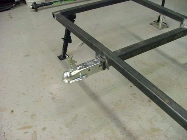

Postby WarPony » Thu Mar 31, 2011 6:54 am
Loader wrote:David,
Warpony had a removable/retractable tongue on his Jim Dandy Build. Might want to ask him about it.

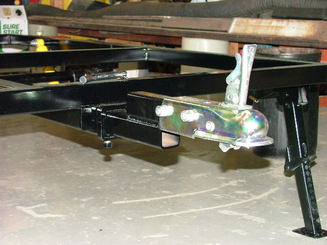

Yes, the pictures Earl showed are mine. I bought a 36" reciever at the place I bought all my metal and used 2X2, 3/16" walled square tubing. I wasn't sure of the length I needed so I just got a 5 foot piece at the time. After I got the coupler welded onto the 2X2, I slid the 5 footer into the reciever, hooked it up to the truck we had then took it out into the parking lot and drove in a circle. I got out to see how close the corner of the trailer was to the bumper and then slid the tongue til there was about 6" of fudge room and marked the tongue. Pretty good engineering, huh? :lol:
It always worked great and got alot of compliments on it.
