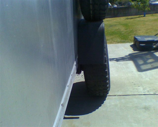

Postby notned » Wed Apr 06, 2011 2:54 pm
I tried to take a picture underneath but the lighting wasn't good.

Postby John Palmer » Thu Apr 07, 2011 12:01 am
notned wrote:Image
Try to picture this.........Place your floor jack under the bend in the axle (hopefully it's bent in the middle)........then place chains under the jack and out around the ends of the axle.........raise the jack and it will pull the axle ends down. If it's bent close to one end, it's harder to bend back with this method because you don't have any leverage. Any "REAL car or truck alignment shop", not the current generation of "computer shops" can do this in twenty minutes.
