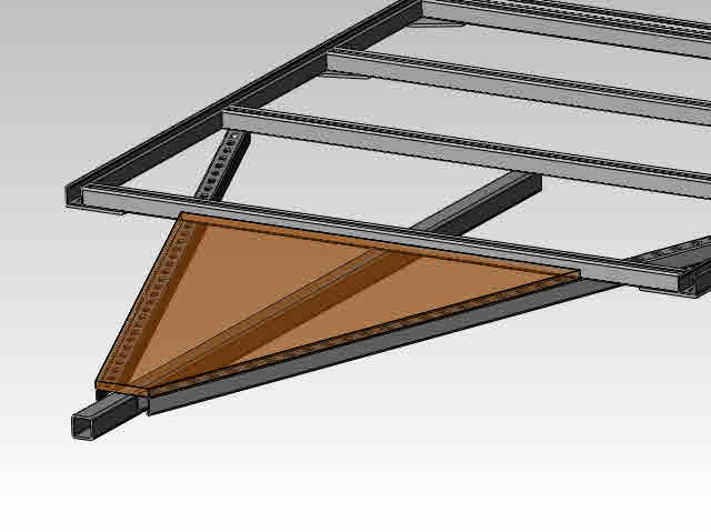

Uploaded a couple of images of a solid model of a strut channel chassis using 1 5/8" x 1 5/8" channel. I looked at some and it is pretty stout stuff and I am amazed at the number of brackets and connectors available. Fastenal has a ton of different things for it.
This is a bottom view of a 5x8 chassis. I don't have all the brackets on and I may have too many cross pieces. I'm thinking that mounting some half axles would be a snap.
This is an iso view showing the tongue deck whick would serve to reinforce strength. Again, still missing some brackets. Need to work on the mounting of the tongue.
The channel runs about $27 for 8 feet. I calculated a little over $200 for the channel used here (not counting the tongue or brackets so far). I'm not expecting to be cheaper than a HF trailer, but looking for flexability. The telescoping channel would be great for framing up a slide out. The great thing about this is no welding required. Most places that sell struts will cut them for you also.

Postby HandyAtLeast » Tue Apr 19, 2011 3:19 pm
I'm rethinking the orientation of the channel on the chassis. I have the channel facing up to the trailer and the slotted back facing down with no way to seal from water. If I face the channel down, I can seal it with closure strips on the bottom and end caps ofn the ends easily. The floor of the trailer would mount to the slotted backs of the channel, or the channel could be unslotted and drilled for mounting/bracing.

Postby schaapveld4 » Tue Apr 19, 2011 3:19 pm
I use strut on a regular basis at work. if you're going this route, you may want to use double strut, it is two pieces of strut welded back to back. its lot stronger for what your thinking of using it for. as for all of the connections, check the quality of the strut nuts (they slide inside the strut and kind of lock themselves in place) I've had some of them snap in half if over torqued. Also I'd recommend using some locktight on all of your bolt threads as they will see a lot of vibration going down the road.
good luck

Postby angib » Tue Apr 19, 2011 3:35 pm
The trick with this strut is how to make the tongue/A-frame, because I reckon almost anything is strong enough for the rest of the frame under the body.
So I ran some numbers on the bigger of the two slotted deep channels, 3-1/4" x 1-5/8", and it comes out about the same vertical strength as a 2"x2"x1/8" square tube. So I think two of those deep channels would make a perfectly good A-frame.

Postby eamarquardt » Tue Apr 19, 2011 3:45 pm
How does this stuff compare in terms of weight to tubing. Being that one face is open you lose a lot of strength for the weight. I don't think you'll ever be able to seal it sufficiently to prevent any water entrapment and the resulting rust. Where you live, I'd be concerned about corrosion.
Plain steel tubing is probably a lot cheaper than the strut material.
Welds, unlike nuts and bolts, rarely come loose. If you network around a bit and find someone with a chop saw or band saw and welder you can build a frame in a morning.
I'm still a fan of building versus buying a HF or similar frame.

Postby HandyAtLeast » Tue Apr 19, 2011 4:16 pm
schaapveld4: Yes, I think the double would be better. And from what angib says, I'm going to look more into it.
eamarquardt: Welds are definitly better, I know. Sealing this frame might be too much of a problem. But I've always liked Erector sets and this is a nice big one.
