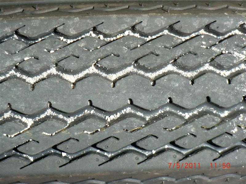

OK, so the Litehouse has 800 miles under the floor pan, and the "4.80x12" tires I purchased from the local trailer supply seem to have magically turned into 5.30x12.... Go figure.
They also have an odd wear pattern.
There's two shoulders and three ribs here. If you look closely at the "bottom" rib in the photo you'll see that there's a ghostly remnant of the circumferential yellow stripe that still runs over the blocks of the rib. The only wear on the tire is on the center rib.
To me, this says "overinflated". Currently I'm running 25PSI in the tire, and the entire casing remains cool to the touch after hours at 60-70MPH except for the center rib, which is warm.
Should I deflate things still further? Should I get radial tires? Any other suggestions?

I'll through my two cents in as I have spent many years looking at tread wear to determine proper inflation, caster and camber.
1) You will need to put more miles on your trailer before you reach any positive conclusion. It will require several hundred miles before your tires begin to break in.
2) Yes, if the tire is only warm in the center, then the center is your primary contact patch. In a perfect world, the tire should have equal temperature across the entire surface.
3) The tire pressure requirements will change based on load. If your trailer was fully loaded during this test, then yes, I would recommend reducing the tire pressure approx 5psi (Provided the tires have broken in.)
4) You can get down to approx 15psi safely on a trailer without loosing a bead. (under most applications). But, if you add significant weight, you will need to increase pressure.
5) Real world observation; While driving, note the sidewall deflection while transition up/down driveway lips, over speed bumps, off curbs, across pot-holes, rounding corners at considerable speed and traveling straight at or just above normal highway speeds. (A video camera mounted to your TV or trailer will provide you with video to review under safe condition rather than hanging your head out the window while someone else drives.) A) Some deflection is good. You want to see the sidewall deflect minimally with the small obstructions and significantly more with the larger obstructions. But, not deflect greater than 30% (approx) of the normal sidewall height with severe obstructions (Too much deflection represents to little PSI, No deflection represents to much PSI) B) Also, you do not want the width of the tire at the sidewall, to decrease (narrow) with highway speeds (this indicates to little PSI.) C) You want to insure that while cornering at significant cornering speeds, the tire does not roll to the side more than approx 15% of its width. (Too much roll could blow a bead.)
6) You may never see proper tire wear if your tires are rated for a load significantly greater than the actual weight of your trailer. As the tire rotates, the centrifugal force influences the contact patch of the tire. It may be your trailer may not have enough weight to overcome the centrifugal force resulting in the center of the tire always experiencing the greatest load/wear.
The most accurate method of identifying proper tire inflation is observing tire real deflection under normal and abnormal driving conditions -and- measuring actual tire temperatures across the surface of the tire immediately upon stopping the vehicle.

I'd like to thank you for taking the time to produce the most concise and informative single-source bit of information I've been able to finsd on the whole of the Web - seriously, I searched a *lot* before asking this one.
More questions, though... :)
proformance wrote:1) You will need to put more miles on your trailer before you reach any positive conclusion. It will require several hundred miles before your tires begin to break in.
It's been about 1200 miles now, and at 25PSI there's still no noticeable wear, and the contact patch is still less than an inch out of five or so. I think I'll plan on going to 20PSI for the next trip and see what happens then. The fenders aren't installed yet, so it's really simple to hand-check tire temperatures at rest stops, and it's still "cool tire with warm center bead" all the time - no flexural/frictional heating in the carcass at all.
This is what makes me ask questions - I'm pretty close to 15PSI already, and the trailer's still a bit bouncy and the tire's still round in cross section. Would radial passenger car tires (145SR12) hold a flatter cross section better with light loads, or should I start adding strategically placed sandbags?
Haven't had a chance to rig the GoPro Hero and go do a cloverleaf and short freeway run yet, but best I can tell from looks back in the mirror there's little or no deflection going on.
I'll be happy to wear tires funny, just so long as I have a reasonable confidence that I'm not likely to either shake the trailer to pieces or lose a bead on an onramp.

5,300 miles later, with less than 500 lbs. all-up on my 5.30x12 tires running at 25PSI, and I've still not rubbed the little molding nibs off the outer rows of tread. Tread temps peak at "warm" in the middle, with the tread edges being "cool" and the sidewalls being "a little warm". Anyone ever use an infrared thermometer to measure sidewall temps? What's "too hot"?
The trailer bounces very little as long as it's weighted to over 400 lbs. - I think it helps that 50 lbs. of that is a futon mattress (mass damper deluxe...). Empty requires avoiding bumps.
Thanks to all for the info so far, and especially to Bruce for pointing out the tire chalk trick - I'll use it when I fully load the trailer in October for the trade shows.
