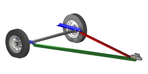

Postby angib » Sat Sep 03, 2011 7:56 am
Please note those (metal) diagonal braces on the front of the Wanderbug, from the tongue up to the body sides - it is they that will carry the vertical load from the coupler, not the much more flexible wood A-frame. Leave out the diagonals and I reckon you're good to drive well over 10 feet before the A-frame snaps off......
And every time I see that illustration, the huge notch cut in the two A-frame members where they cross the front of the body make me scream - it's like cutting out a floor joist to get a cable past.

Postby angib » Sun Sep 04, 2011 6:16 am
Yes, with proper use of epoxy, everything changes. I still don't like that notch as it replaces half the along-the-grain A-frame piece with some much weaker (like one quarter as strong) across-the-grain wood, but maybe it wouldn't be a problem.
Just for laughs, I've worked out the trailer weights that the Australian trailer rules would allow for a 2x4 timber A-frame. I've assumed 1,000 psi bending stress (so this is good quality timber) on two nominal 2x4s (ie, actual 1.5"x3.5", right?) with a 10% material margin.
The result is 5510 lb-in bending strength - with the Wanderbug's 32" tongue length from the coupler to the front cross-member, that means a maximum trailer weight of 340 pounds. I believe for the gentle use a teardrop receives, compared to the utility trailer abuse that the Aussie rules are designed for, this figure can be safely doubled and 680 pounds is probably about what the lightly built Wanderbug would weigh. Throw in those diagonal braces and it looks plenty strong enough - without them, it appears to be right on the limit, though not over it.

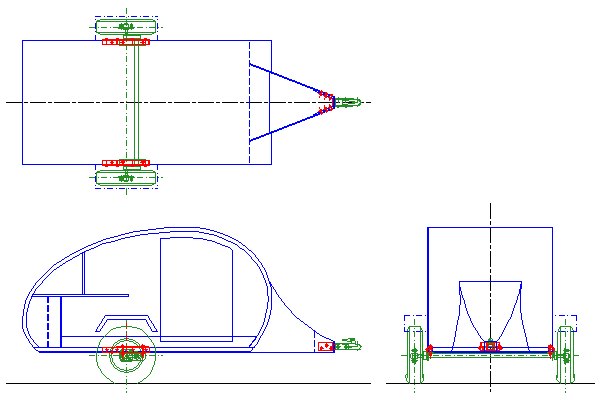

Postby angib » Mon Sep 05, 2011 5:02 am
Actual 2x4s would increase the strength by 75% so that the Aussie rules rating would be 600 pounds for a utility trailer - so 1200 pounds for a teardrop.
dwgriff1 has done something similar, except that he put in braces in two directions which will carry most of the tongue loads:
This illustrates that a teardrop is a strong enough monocoque to be self-supporting - it just needs some local reinforcement to attach the suspension and coupler to it.
I think imitating a metal frame in wood isn't the best idea. dwgriff1 illustrates one alternative and some time ago I drew a similar idea where I used a deep plywood box A-frame that just tied the coupler straight into the body with no imitation frame at all:
But I think it's still sensible to add some metal (red in the illustration) to spread the load where the coupler and axles bolt on and really it's a lot simpler to use a metal A-frame that just bolts on, like the Superlight:

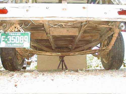

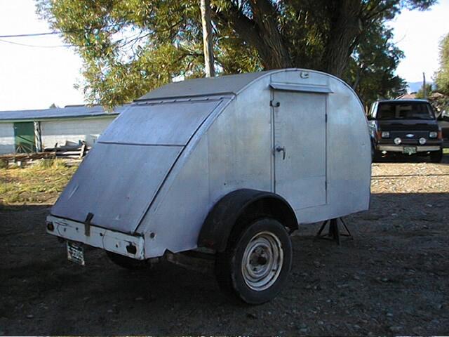

Here is an old teardrop with a wood frame and metal A-frame that has lasted long enough to become an antique:
It's important to recognise that the only part of a chassis that needs much strength is the tongue/A-frame - all the tough frames under under teardrop bodies you'll see around the forum are just people trying to imitate house foundations. The best example of what strength a teardrop floor actually needs is to look under a wood double bed as they have more strength than a teardrop floor needs - as it's unlikely a teardrop is going to get an 8-year old using it as a trampoline...
