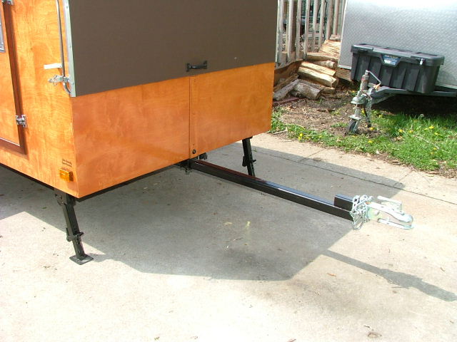

Although I haven't seen the folding tongue, I do know that WarPony built a nice trailer with a removable draw bar, might be an option if the folding A-Frame falls through.
From his photo album

You could make a removable A frame like the HF folding trailer has, but you would have to crawl underneath to pull the pins. Or make a combo A frame/straight tongue like Loader's photo. That would make it easier to line everything up. The straight tongue would insert into the receiver, and the A frame would line up with brackets that take pins.
