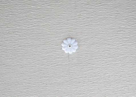

Put it in Rip Van Winkle worked great looks good and wipes clean with a damp rag.
My spars were 12" o/c. I pre drilled and screwed using rosettes to reinforce the contact area and eliminate pull thru.
This tiny trailer is only 4 foot wide so I screwed about 5 inches off each sidewall and in the exact center making spacing less than 20" apart.

The panels were marked as wall panels. They felt pretty thick, but I figured someone would have an answer. Now to source some rosettes...

parnold wrote: Now to source some rosettes...
HD carries them, hardware aisle in the slide-out trays. Can't recall if they're white, think they are clear.

Not exactly the same thing, but I used FRP for the under side of my hatch:
Instead of the rosettes, I used screws covers that I bought at Lowes. There is an eye that is fastened and an attached cover that snaps over the screw head.
On the sides, I used the j-trim - tacked it into place with a staple gun. Then I slid the FRP into the j-trim. I don't know the exact dimensions but the spacing on the hatch ribs was about 18".
