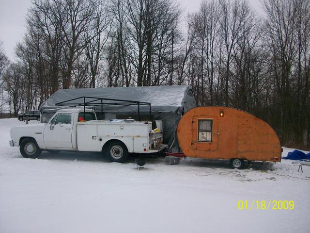

I had a home made truck rack for my 1 ton pickup made out of 1 inch square stock and had on several occasions hauled 1000 to 1400 pounds of lumber on it.
It was trussed in a manor such as I have drawn below. It makes a mini truss that places the top cords in tension to assist the flat bottom cord. I think this would work well for a teardrop. Allow the 2 short verticals to fall about where the mounting holes are on the axle mounting plate to help transfer the load to the top cord.
