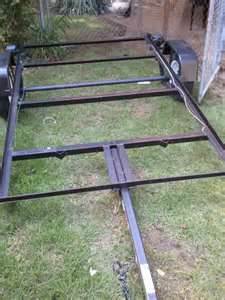

lee senn wrote:Thanks Woodbutcher for the really good photo of the northern tool trailer. Having seen it up close It appears that in order to accomodate my proposed plan I will be better served to bite the bullet and have revisions made to my original trailer. Thanks again for your input it was very helpful in making a decision. Lee
