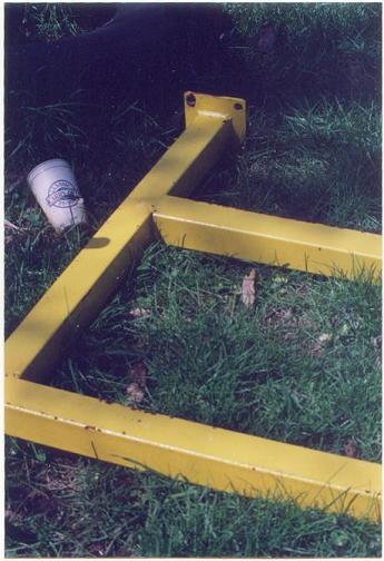

I cut and widened my axle and built a carriage for it. Took about a day to do, plus about $60 worth of steel
3329133290
