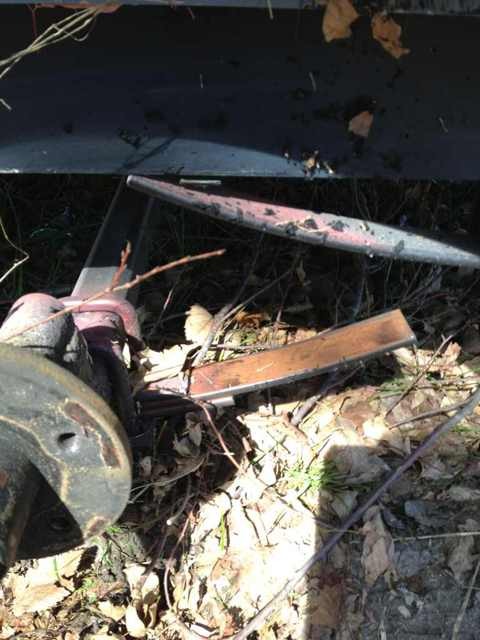

Postby Fishingtomatoseed » Thu Feb 07, 2013 8:05 pm
I had posted this in our trip in the south central section. But wanted to put it here just to give anyone else looking at trailer stuff a warning.
We finally made it. A one hour trip turned into a 5 hour trip.
Leaf spring decided to break. This would be a warning to people using old springs that they salvage from using and old trailer.
Had an extra one at the house so we left the trailer in bar ditch and headed home.
It's fun doing repairs on the side of the road on the dirt.
You can see rust where it has been cracked for a while. Never noticed it during the build. So I don't know when it happen and it is stored inside. So I guess it has been there for a while.

Re: Broken leaf spring
Postby Fishingtomatoseed » Thu Feb 07, 2013 8:10 pm
How would you be able to find a crack in a spring? Magnet and metal dust? Just the sound of it when it rings?
I read through the leaf spring rebuild in this section. I believe I will be doing that to this trailer before another trip.

Postby Kody » Fri Feb 08, 2013 9:32 pm
Fishingtomatoseed wrote: How would you be able to find a crack in a spring? Magnet and metal dust? Just the sound of it when it rings?
It's easy to find a hidden crack in a spring or weld. The time honored method is to use dye penetrant. This comes in a two pack kit. One can is a spray that you apply over the area that you want to test. It is sprayed on and left for a minute or so, then you carefully wipe it off. The second can (a white powder substance) is then sprayed over the area and the dye in the crack is sucked out by the powder stuff. The dye is a red crimson colour and instantly reveals where the crack is and how long it is. I used this stuff at the uni where I worked as a technician, it is testing by the "non-destructive" process. You should be able to buy the kit, it's not that expensive, from any good machine tool outlet. If a fatigue crack has developed, this is quickest way to find it. You must clean off all the dirt and crud before using on the test area.
If both springs came from the same source, the other one should also be replaced when you get home to prevent this scenario happening again.

Postby Shadow Catcher » Sat Feb 09, 2013 10:42 am
Using penetrant is easy to do and obtainable at many/most weld supply places. The process harkens back to the steam era and the 'oil and whiting' method. The part was cleaned and kerosene sprayed on, the surface is cleaned and talcum powder sprayed/sprinkled on, capillary action draws the kerosene up and into the talc. The materials to day are dyed either with a visitable dye, red or fluorescent dye requiring a black light. The key is that the part MUST BE CLEAN or it blocks the dye penetrating into the discontinuity.
For ferrous material magnetic particle testing is the best option and is less likely to be affected by dirt, rust, oil, paint that can block penetration of the crack/discontinuity. If you decide to use penetrant I can send you a procedure.
