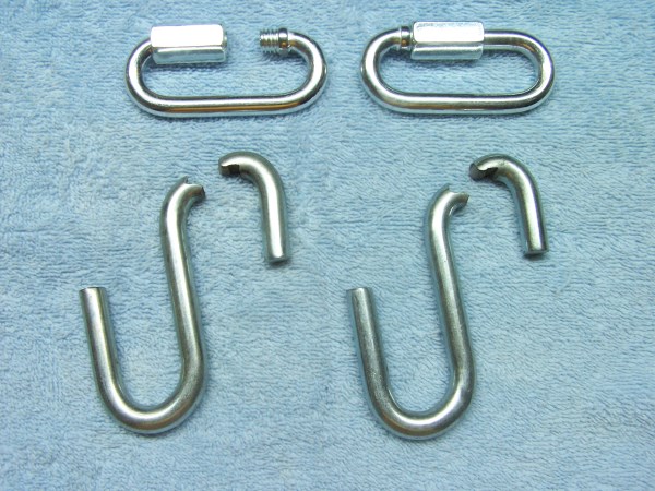

Postby les45 » Thu May 23, 2013 12:49 pm
I decided to replace the hooks on the safety chains on my NT trailer with Reese quick connectors for a more positive hookup. When I went to spread the hooks to get the chain off, they both shattered in exactly the same place and with the same type of failure. I was wedging them apart with just a couple of light blows on a chisel when they broke like this. I'm figuring that is not a good thing. I looked this up online and found other similar hook failures that occurred on the road with Chinese made parts. Unfortunately, when I looked at the Reese packaging, the quick connectors were made in China too. Now I'm going to replace the chains and connectors with something American made (if there is such a thing nowadays).

Postby Shadow Catcher » Sat May 25, 2013 7:33 am
When I had the accident One of the quick links pulled straight and the other broke, which should not have been possible had they been to code. The chain should have gone first. I have replaced the chains and links with heavier ga chain and links that are stainless steel.
Chain is subject to ASTM standards, but how much is made in China that does not meet those standards.
There are different grades of chain and insisting on chain that meets a standard would probably lead to a good quality chain. You also need to know that there is chain from China that meets ASTM standards.

Postby les45 » Sat May 25, 2013 9:23 am
Couldn't find anything with a pedigree in my area so I decided to go with the larger Reese chain set (5,000 lb) with quick connectors. They are nearly twice as big as the ones that came with the NT trailer. Probably overkill but reduces the worry factor. I noticed that the instructions say to loop the chain through the hole in the receiver plate and fasten the connectors back to links in the chains and not directly to the receiver plate. I have never seen anyone do that when using the quick connectors. My only concern now is that piddly little Chinese bolt in the center that holds the chain to the trailer tongue plate. I guess that gets changed out next with a high strength American bolt (if there is such a thing nowadays).

Postby les45 » Sun May 26, 2013 9:18 am
The Reese box says the connectors are rated at 5,000 lbs. That is the same rating for their larger chain set which uses the same connectors. However, there are no pedigrees written on the box or stamped on any of the hardware. I thought it interesting that the broken hooks were stamped "SAE Aprd". Not sure that a written or stamped pedigree means anything on imports like these.

Postby les45 » Wed Jun 19, 2013 10:54 am
Rolly wrote:Possible solution for hooks.http://www.tulsachain.com/asccustompages/products.asp?AffID=&categoryid=438&navParent=437
Rolly
I see more people using this style of hook, especially boaters in our area. FWIW and a followup to my original post, I took the S-hooks off my HF utility trailer recently using the same chisel method and they separated cleanly without breaking. Not sure if they are any stronger, but at least they didn't break on impact. I went ahead and replaced them with the positive locking quick connectors also just to be on the safe side. Cheap insurance.

Postby Redneck Teepee » Tue Dec 31, 2013 1:08 am
les45 wrote:I decided to replace the hooks on the safety chains on my NT trailer with Reese quick connectors for a more positive hookup. When I went to spread the hooks to get the chain off, they both shattered in exactly the same place and with the same type of failure. I was wedging them apart with just a couple of light blows on a chisel when they broke like this. I'm figuring that is not a good thing. I looked this up online and found other similar hook failures that occurred on the road with Chinese made parts. Unfortunately, when I looked at the Reese packaging, the quick connectors were made in China too. Now I'm going to replace the chains and connectors with something American made (if there is such a thing nowadays).
The stuff made in china always seems to be over hardened and as you found out very brittle, same with their tools....Junk!
