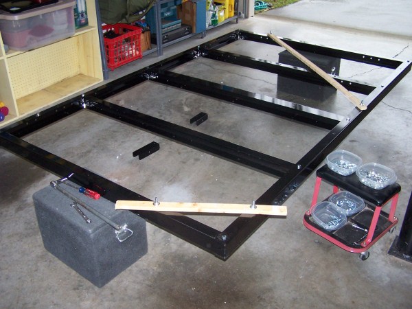

simple way to square the trailer frame while bolting:

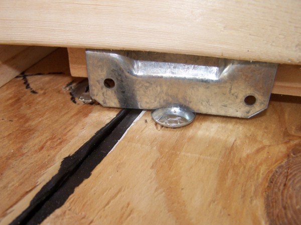

roof truss brace kept carriage bolt from turning while fastening plywood deck to trailer frame; I cut slots in the bolt heads with a Dremel tool and used this for the interior bolts that I couldn't reach with both hands. jig is held in place with a long 2X4 clamped to the edges of the trailer frame:

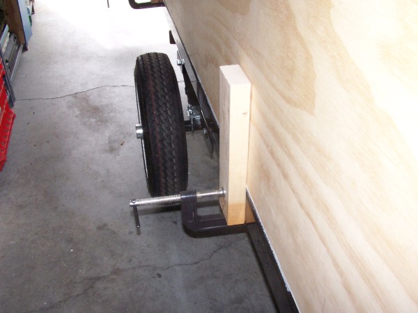

two of these held the 3/4 plywood walls at the bottom while screwing into bottom perimeter board; you have to place a small piece of wood inside the C-channel for the clamp to grip good:

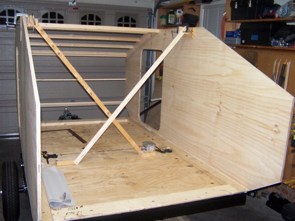

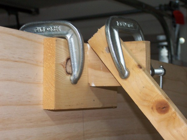

this held my walls at the top while squaring them with the floor:
overall view of temporary wall supports; used for squaring walls and while installing spars:

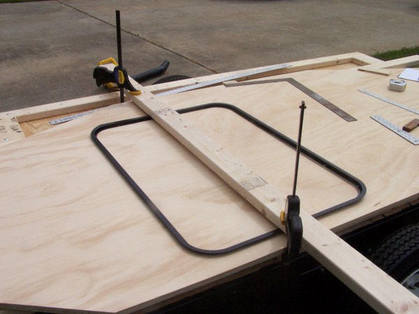

2X4 and a couple of clamps hold door ring in place for marking cutout for door:
