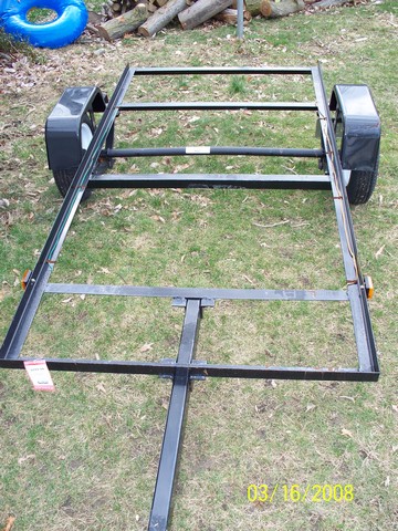

I have a harbor freight trailer trailer which has v type tongue. The metal is C shaped. As I look around I have found some tongues with cross bars and some with a solid bar coming up the middle I do not want to much weight up front anymore the the required weight needed in towing.
There are several forums out there that talk HF trailers for their hobby. One is a group that flies Remote control planes.
How have you reinforced yours. Or how would you reinforce it.
I have seen 1 or 2 cross bars, 3 with thick bars against the back of the C bar, I have seen 1x1 metal square tube up the middle with or with out reinforced cross bars. And one where the V was removed and replaced with one 2x2 bar up the middle and then reinforced with angle irons at the end of the trailer.
once you have had one tongue brake or bend when on the road you do not want to have a repeat performance.

I think there are two entirely different things going on here and it doesn't help to get the two mixed up:
- reinforcing the tongue of the HF trailer;
- lengthening the tongue of the HF trailer.
Most of those examples show lengthening and in one case weakening (not reinforcing). Adding steel in the wrong place does not make the tongue stronger.
What matters is the strength at the point of maximum bending, which is at the point where the tongue leaves the front of the main frame. To reinforce a tongue, this point and a good length in front and behind that point need to be strengthened.
So this photo is a good example of really bad practice. The tongue has been lengthened by adding the central single tongue, but it hasn't been reinforced at all at the critical point where it leaves the main frame. The longer tongue makes more leverage but the strength is the same - the result is that the carrying capacity is reduced. If the trailer is only going to ever carry a small load, that might be OK (and RC planes are unlikely to be very heavy) but it's still an dangerous idea to modify a trailer so it can't carry its rated capacity/GVWR.
On the other hand, this looks like a sensible lengthening and reinforcing (though the lengthening requires reinforcing, so the capacity may be no greater than the original trailer). The extra central single tongue is adding to the tongue strength at the critical point and it continues well back into the main frame - as far as the third cross member. Picking up more than two cross members doesn't itself give much benefit (in this example, the second one will carry very little load), but the important thing is the good distance the first and last cross member picked up. As a rule of thumb this should be at least as much as the width of the main frame.
And making this mistake is not just for amateurs - some Carry-On trailers sold by Tractor Supply and Northern Tool have exactly the same problem and forum members have reported problems with the second cross-member bending under the tongue load (for one guy, it happened while he was still building his teardrop body!). They fit a perfectly good enough single tongue, but it is attached to fairly weak angle cross members that are positioned way too close together. Long before the tongue reaches its maximum load, the second cross member fails in bending.

The Northern tool trailer I built the barn on had a failing front crossmember just as Andrew has stated. I replaced the tongue with 2 x 2 x 3 /16 square tube and ran front to rear and was able to add this.....
My HF trailer has also been modified with the 2 x2 x3/16. My welder buddy stopped the tongue just before the axle fearing it might interfer. I Ireally wanted to take it to the rear for yet another rear hitch. He surprised me and added a 3 1/2 foot section across the last 2 crossmembers and shimmed and drilled it for a 1 1/4 drawbar or accessories.
