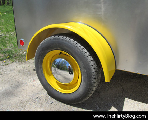

I've used old Mopar wheels with no problem on the Flexiride with a 5 on 4.5" hub. You can get them up at a pick and pull or junkyard pretty inexpensively beats the price of a new wheel and you're probably going to want to paint or powdercoat them anyway. Doug

Postby aggie79 » Sun Sep 22, 2013 8:55 pm
Don't know if it helps bit I've got steel car wheels on my dexter axle. I was more worried about being able to fit the moon hubcaps than the wheel fitting over the hub.

Postby alaska teardrop » Mon Sep 23, 2013 7:53 am
    Kim,
    Vintage Trailer Supply sells steel wheels & moon caps made for trailers. Note that the wheels have a 1/2" inset (positive 1/2" offset) & 2.62" center hole that fits Dexter hubs.
