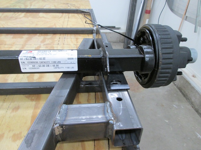

    Although there are multiple threads on modifying a trailer like yours for various reasons, I've never read of anyone installing a torsion axle on one. I've long thought that simply bolting on a torsion axle would easily resolve a number of these issues if one was willing to spend the money.
    With a torsion axle you can determine the correct suspension rate for the load, ride height, hub bolt pattern for the wheels of your choice, distance between the hub faces according to the body width & tire clearence, axle location for correct balance & tongue weight AND you can order brakes.

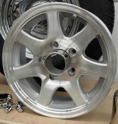

    A #8 Dexter axle costs about $400. with brakes. A set of aluminum trailer wheels & all season radials costs about $350. Here is an example of wheels made for trailers. http://www.southwestwheel.com/store/c-5 ... heels.aspx Your local tire dealer is a good source for ordering wheels.
    Another suggestion would be to build your trailer, weigh it & then order the axle accordingly. If you where to go this way, I'd be glad to help out with determining specs.

    Example aluminum wheel & all-weather radial:

    Some thoughts: Will your HF hubs & bearings fit the half axles or will you have to buy new? Mounting would require a plate on both sides attached to the side rails & one of the cross members. Half axles require alignment & keeping them in alignment. Those axles have a 45* down start angle. How much does that lower the ride height? Also, 45* down is not the best for a smooth ride on a lightweight trailer. (The start angle on Flexiride half axles are adjustable, but they are more money). On either the Northern Tool or the Flexiride half axles the distance from the side of the trailer to the hub face is about four inches, which limits the tire size, an issue many others on this forum have addressed with wheel spacers, offset wheels, replacement axles, ect, ect. The 1000# load rating is a bit too high for a smooth ride on a 600#-800# trailer (IMO). You can't add brakes if you wanted them. (BTW, the #8 Dexter can be ordered without brakes for about $280., but with the brake flange mounts if you wanted to add brakes later).

    I may sound like a naysayer, but that is because I've read so much on this forum of hard work, anguish & money spent modifying what is basically a utility trailer meant for the occasional short run fully loaded at low speed for short distances & most likely pulled by a truck.
    Again, the reason for suggesting the #8 Dexter is because (IMO) it resolves all of these issues for usually about the same amount of money & a lot less work. And, the larger (14-15") good quality radial car tires which can be run at a tire pressure that matches the load (e.i. low pressure on a lightweight trailer) mounted on aluminum trailer wheels makes for smooth & safe towing in my experience.
