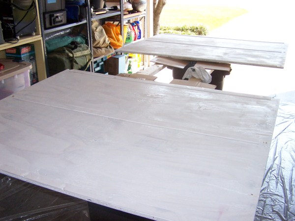

I glued 3/16" wood strips over area where crossbars would be. The entire bottom side of my floor deck received two coats of Zinsser oil based primer plus two coats of Henry's 107 asphalt emulsion.
