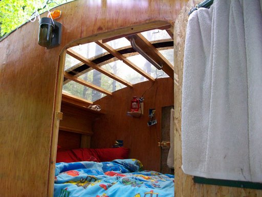

As my planning progresses, I'm leaning more an more towards a sleeper TD, on the HF 4x8 frame, and keeping it 4' wide, using a simplified benroy profile. Right now, I'm leaning towards using single full, unframed 4x8 3/4 sheets for the sides, and attaching them to the frame on the sidewall.
In a few months, before I start my build, I expect that my wife and I will be renting a TD for a weekend and testing it out. That way we'll be able to tell if the smaller size will be too claustrophobic or not. I am entertaining one idea of having a (mostly) plexiglass roof and wonder if that will help with any of the claustrophobia.

Postby bobhenry » Thu Aug 14, 2014 8:39 am
Yes Yes and Yes. You feel like you are outdoors.

Postby dperry324 » Thu Aug 14, 2014 9:37 am
bobhenry wrote:Yes Yes and Yes. You feel like you are outdoors.
Thanks, I just started another thread on this in the skinning section. But I will have to check out your build on this one so I can get a better feel for the build requirements.
