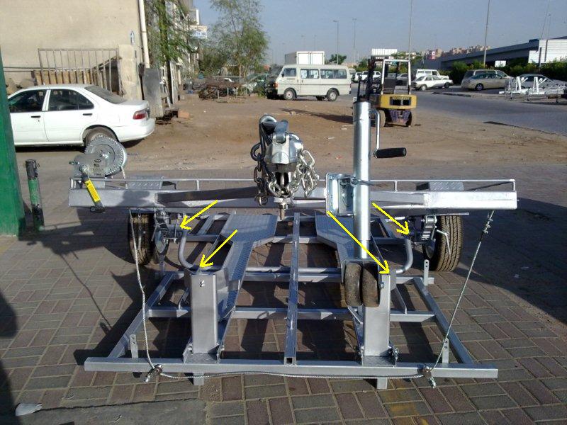

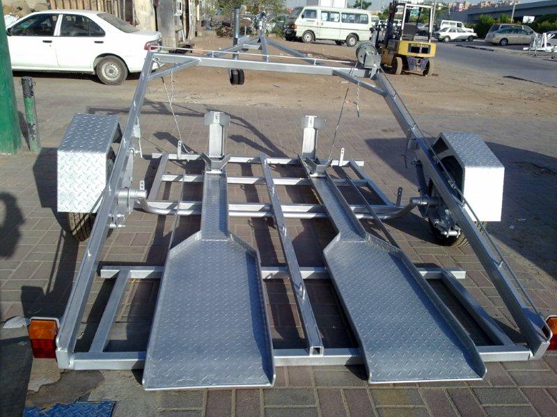

Hi guys, I'm currently building a ground loading trailer, loosely based on some designs I saw online. I have a client who needs a two bike trailer, but it should be less than 6' wide. I have seen some pictures online, but I don't really understand how I can make it work without a proper suspension. The one I have made has a double outer frame, so I was able to fabricate an independent suspension for it, but if I do the same for two bikes, it's gonna be way too wide. Can anyone tell me how these trailers would work?

At first glance, it looks like a leaf sprung trailing arm setup with that curved axle piece, but I do not think that is how they work. I think the curved piece is not fully fixed at the front/along the axle. Rather, it just rides in non-load bearing carriers or straps that allow it to move to facilitate the trailer to drop the bed down. The long curved axle piece is probably not fixed to the drop down part with a bearing or hinge,and can probably slide backwards and forwards a bit. Those look like they do not work if they are hooked to the TV, they would need to be unhitched to drop the rear down to the ground, like they show. The curved axle is probably there for nothing more than lateral wheel spacing and wheel alignment or camber.
For a different design you can look at manlift trailers that drop down to the ground, their stub axle setups use leaf springs top and bottom or torsion stub axles to keep the axle stubs pointed in the right direction. Maybe you used torsion stubs on your first independent suspension design though and found them too wide?

I agree that it looks like the center/front of the bowed axle must be allowed to slide or float slightly, but it also looks like where it attaches to the spindles is a pivot bearing joint of sorts.

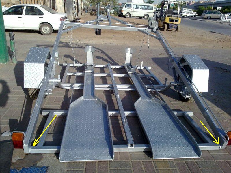

Its a dual pivot system.... First the "axle" pivots in a bearing holder attached to the spring... The second pivot is at rear of trailer ... When the winch pulls the front of trailer down (into tow position) the axle articulates ....Essentially all hoop section of axle does is allow bed to pass through "normal" axle centerline and drop to ground....
Also at rear of trailer the bed has to pivot (hinge) on the rear cross bar to cause the articulation of axle...
I think the key to system that is not obvious is the center section of trailer is not connected solid to axle (hoop) but is allowed to move forward/backwards to allow articulation, the key to system is when bed is in up position it is locked to front of frame and bed and outer frame becomes a single unit that rides on springs as "normal" trailer.... As mentioned above trailer has to be disconnected from tow vehicle to allow full articulation...

So when the triangle between the hub center, rear pivot and axle bow pivot goes flat the spring shackles take up the difference in length? Something has to give. :thinking:

Hoop section of axle is not connected rigid to bed but is probably in some sort of slot just to retain it (and allow it to rotate) .... Also the hoop section is as just a extremely dropped axle which allows center line of axle to drop all the way to the ground....
Replacing bar axle and springs with the axle shown below would accomplish same thing because there is no rigid axle across width of trailer...
