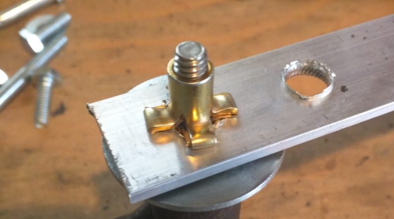

Check out the pre-bulbed nuts (also called plus nuts). They have wings that expand to grip a bigger surface area behind the hole:
Plus Nuts
I just bought some and will be trying them out in the van. Riv nuts and plus nuts are super popular on the the van building forum.

Just tried on of the plus nuts; pay attention to the grip range if you buy them. :roll:

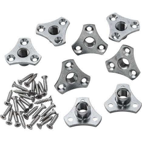

Postby JasenC » Thu Nov 04, 2021 12:52 am
Not a fan of them, I've run across enough spinners on stationary objects, not being drug down the hwy.
I'm going with screw on threadcerts from Rockler placed under my floor sheathing and bolted up thru framing from the underside.

Postby twisted lines » Thu Nov 04, 2021 10:42 am
JasenC wrote:Not a fan of them, I've run across enough spinners on stationary objects, not being drug down the hwy.
I'm going with screw on threadcerts from Rockler .
Haven't seen them !
Thanks TL
