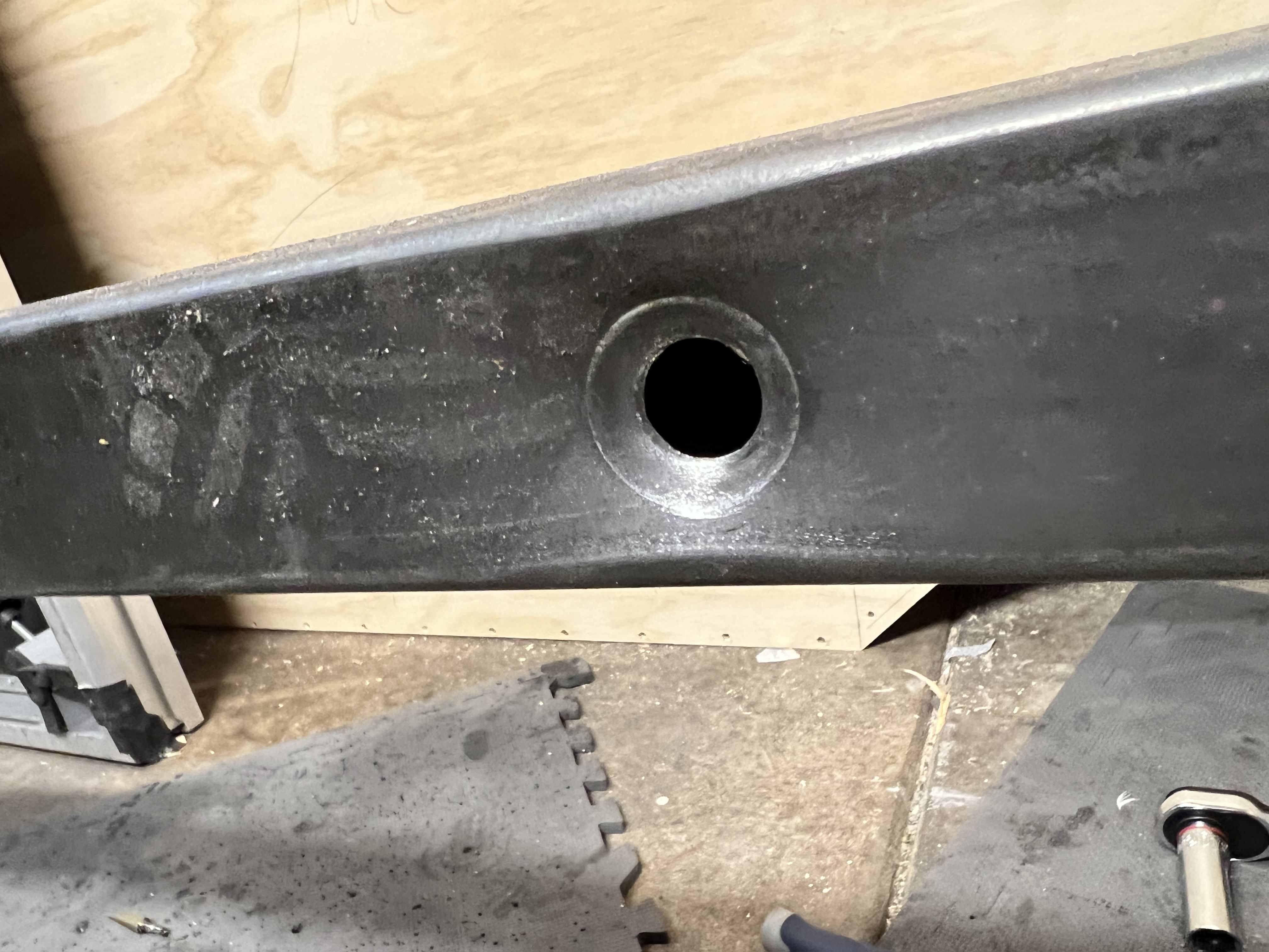

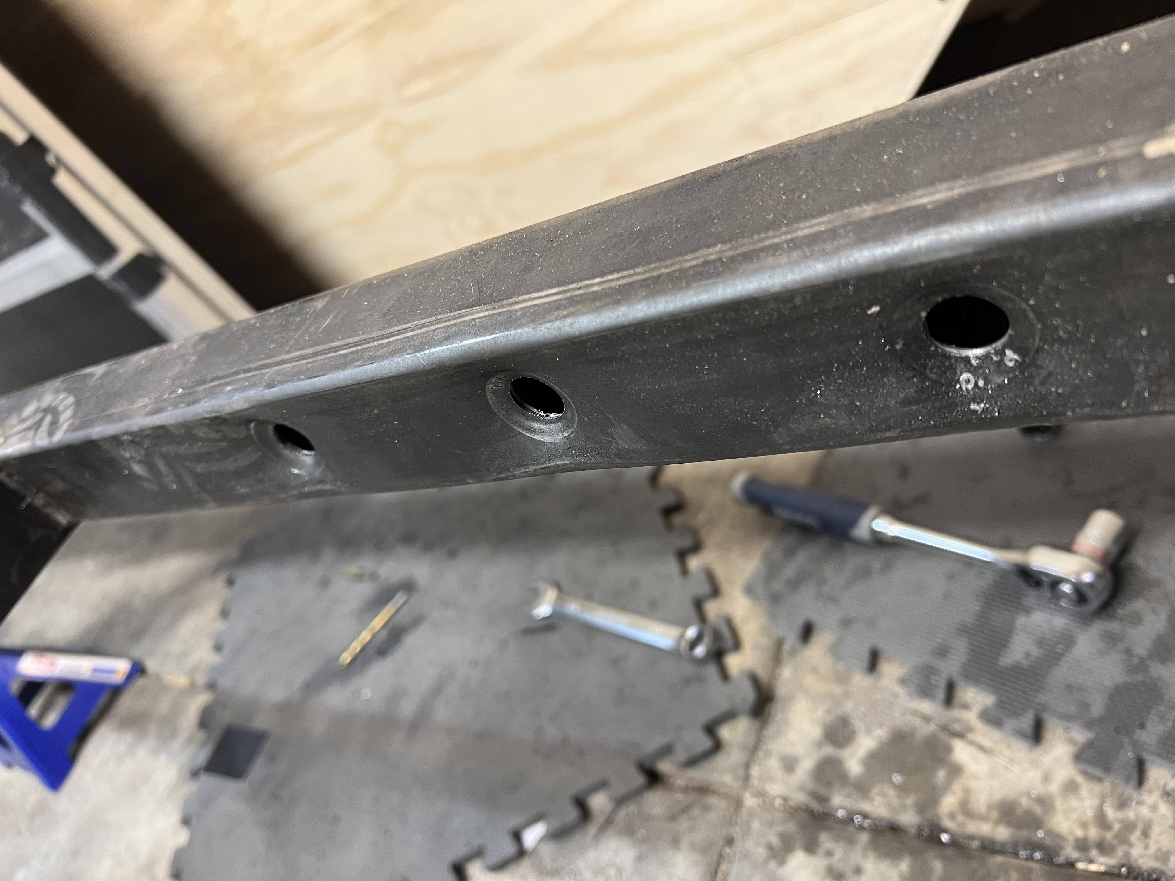

Hi there. I am in the process of building a frame. Last night I installed the Timbren axless system (3500lbs) and used a torque wrench to tighten the bolts to 90 lb. ft. I just noticed this morning that the walls of the square tubing (11 GA (.120 wall)) bent in (displayed in pictures). I'm not really sure how to fix this or what I did wrong. Any help would be much appreciated. This is my first time posting, so hopefully the photos upload ok.

I can't imagine timbren suggests that as an acceptable size to bolt a 3500lb assembly to. Did a tech sheet/install sheet come with it? Consider adding something stronger to bolt your axles to. Care to share your frame design here?

I can't believe 90lbs of torque would do that. Have you double checked the wrench and measured the thickness of steel? It does not look like 11 ga in the picture but it's hard to tell. Something is definitely off.

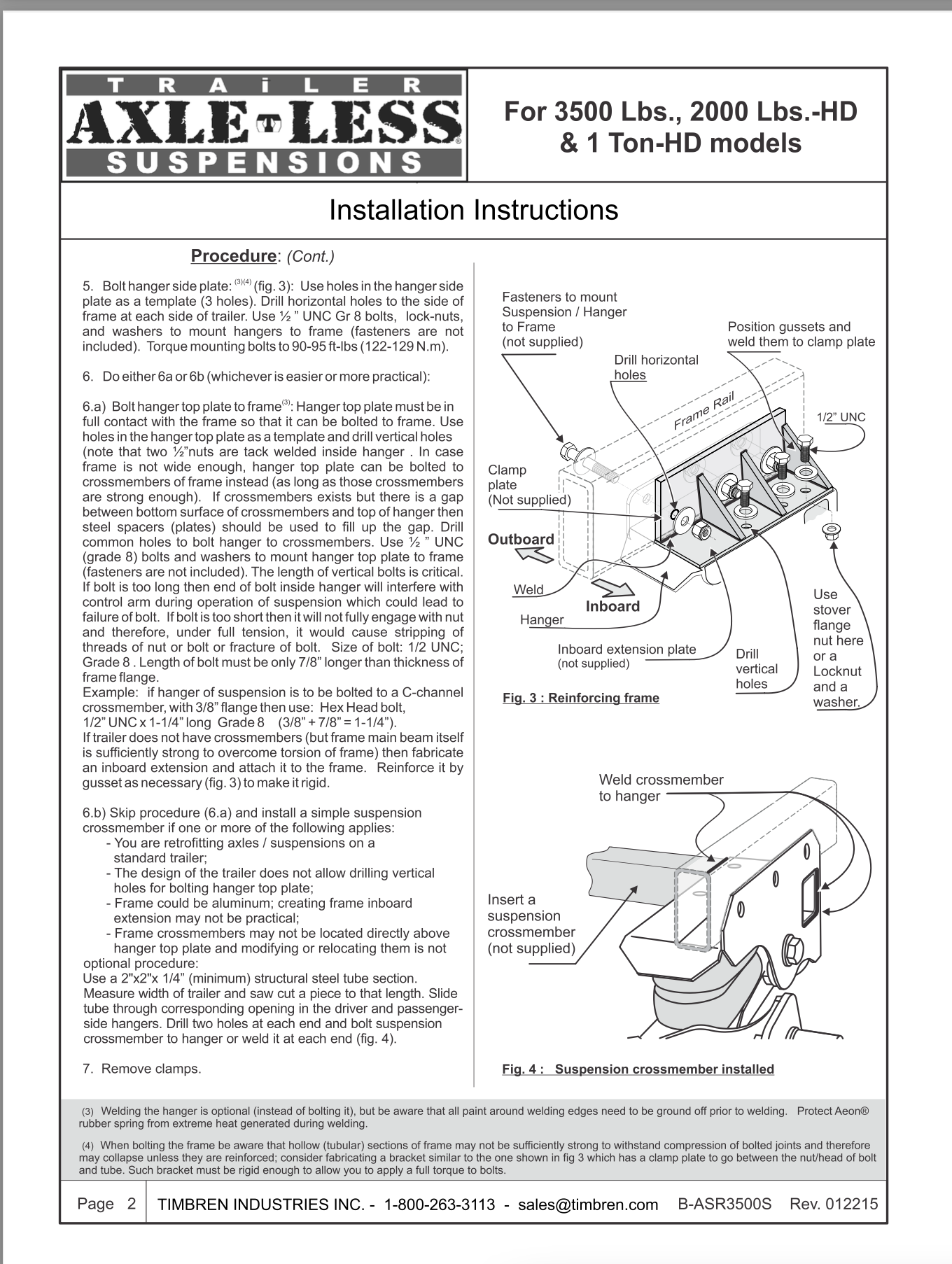

sorry forgot to attach the manual page

Onajourney wrote:I can't believe 90lbs of torque would do that. Have you double checked the wrench and measured the thickness of steel? It does not look like 11 ga in the picture but it's hard to tell. Something is definitely off.
Yea, I too am wondering if it was the wrench. I checked multiple times while using it that it was set to the 90lbs. It was very hard to get each one to hit 90lbs. I will double check the steel thickness.

Postby tony.latham » Wed Dec 14, 2022 3:20 pm
What size bolts? The holes look big.
To me, the obvious fix is to weld 1/4" strap over the damaged section. I might bolt the suspension in place and tack it in place before the final weld.

tony.latham wrote:What size bolts? The holes look big.
Hey Tony, thanks of the reply. The bolts are 1/2''. By strap do you mean a 1/4'' steel plate (cut to size to fit on the tubing) or something else? I apologize, I am fairly new to this.

Postby chopperwalker » Wed Dec 14, 2022 3:28 pm
Could the wrench units be lbs-in? So 90 would have been 12 times what you should have set them to?

Postby Onajourney » Wed Dec 14, 2022 3:39 pm
chopperwalker wrote:Could the wrench units be lbs-in? So 90 would have been 12 times what you should have set them to?
He'd be one strong fella. I can barely tighten to 120 ft-lbs and most only go to 150. I'm betting it's not .12 tube.

Postby cjb028 » Wed Dec 14, 2022 3:46 pm
I just checked and it is .120" . Thinking ill go buy another torque wrench and compare how hard it is to get to 90 lbs (on a scrap piece) and compare it to the torque wrench I used.

Postby twisted lines » Wed Dec 14, 2022 4:22 pm
First Picture shows a plate on both sides the bolt goes through.
Says one is not included :thinking:
90 lbs yes that will bend 1/8" with out spreading the load.

Postby cjb028 » Wed Dec 14, 2022 5:04 pm
twisted lines wrote:First Picture shows a plate on both sides the bolt goes through.
you are right, that is totally what I missed, dang. thanks for the help.

Postby cjb028 » Wed Dec 14, 2022 5:11 pm
you know, thinking back and looking at the manual again, my plan was to do the 2nd option that is displayed in the picture which is to use a 2x2 as a cross-member. Its confusing because in the picture of that method, they do not use an extension plate.

By strap do you mean a 1/4'' steel plate (cut to size to fit on the tubing) ...
Yep! :thumbs-up: You should be able to find 1/4" strap that is the correct width.
