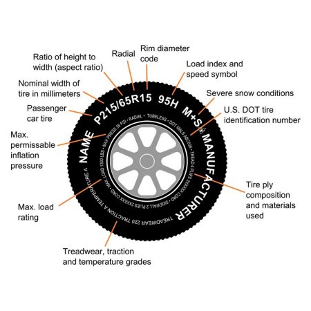

23Sojourney45, tires have specific dimensions just as do wheels
IF you intend to use your TV spare as a spare for the TD i might suggest you take the TV spare and see how it actually fits on the trailer
make sure you allow for wall framing and skinning for your tire clearance
the following image is only for example and does not necessarily specify the dimensions and clearance needed for YOUR application and you will have to plug your needs into the image
there are several tire sizes that can fit on your 15x6 wheels and the tire dimensions ARE needed by any tire shop in order to meet your needs
this image is somewhat generic but you can go to your TV and replace the numbers in the image w/ the numbers on your vehicle
the width of this tire is 215mm
the tire height ratio of 65 in this image means the actual rubber tire results in a tire size w/ a radius equal to 65% of 215mm for a total of 139.75mm (2 x 65% of 215mm for 279.5mm/11" added to 15" would be the assembled tire's diameter of 26"±)
15" auto tires can be purchased from 155mm > 265mm ± wide and the tire store needs to know what size you need/want/think you want
it is sad that the sales person @ wallyworld did not realize you did not understand what he/she was asking about and explain it to you
in all likelihood you need to goto an independent tire shop w/ a more knowledgeable staff and explain what you are trying to do
you will likely get asked more questions that send you home for more measurements
GOOD LUCK W/ YOUR QUEST

Postby 23Sojourney45 » Mon Jul 24, 2023 11:34 pm
gudmund wrote:W-M brand "Douglas All Season" is what they were named, the last time I looked at them (could have a different name by now - they used to be named 'Xtra Trac 2's' when I first started using them..... used them on my Metro's/Swift's for years getting 40/50 thou each out of them (they have a 45 thou mile wear rating) when working - to/from work = 105++mile daily drive, =ing right around a total of 1 million miles driven on the 7 Metro/Swifts I owned since 1987......never a problem with any of them except for the few nails-flats -here/there-........ 25/30thou miles on the teardrop so far the last 6/7 years = no flats or problems yet, either......... (that's paved hi-way "road" wear - I 'DO NOT' go "off-road"................)
That's a lot of mileage on those tires, knock on wood for more! You'd have to get another set of tires for off road, maybe a different axle too depending on the terrain. I will double check to see what the MART has, if not then the LTS would have to do.
23Sojourney45
Posts: 90
Joined: Wed May 03, 2023 1:44 pm
Location: California
Re: Wheels for a teardrop
Postby 23Sojourney45 » Tue Jul 25, 2023 12:02 am
swoody126 wrote:the width of this tire is 215mm
sw
Its sad but these things happen. To be honest, I don't think he knew what he was doing, he was more concerned about why there was no tire on the wheel. I'm glad there forum exist to help out. Thank you!
