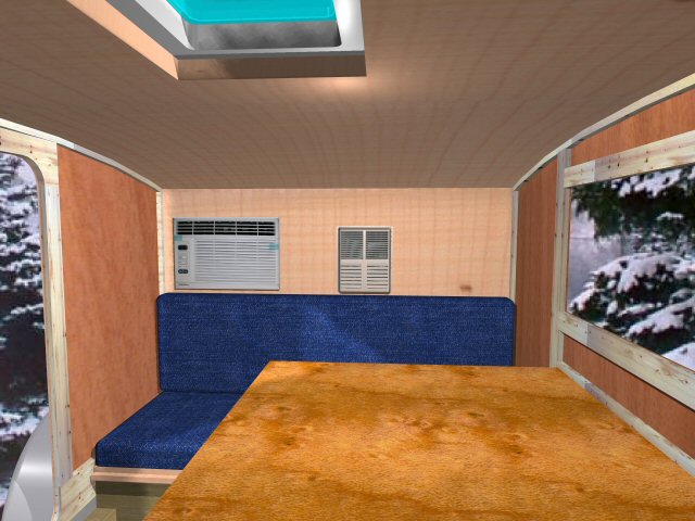

Postby mikeschn » Sun Dec 12, 2004 8:35 pm
Good thing you showed me what you got... I found that one too, it's a preliminary design, not the final design.
Here's the final design...
I'll generate some drawings for you this week...
Postby Steve Frederick » Sun Dec 12, 2004 9:03 pm
OK! I'm a little scared of that air conditioner! :NC I think we'll need to revisit that discussion..I'm wondering how to marry that unit to the roof???
