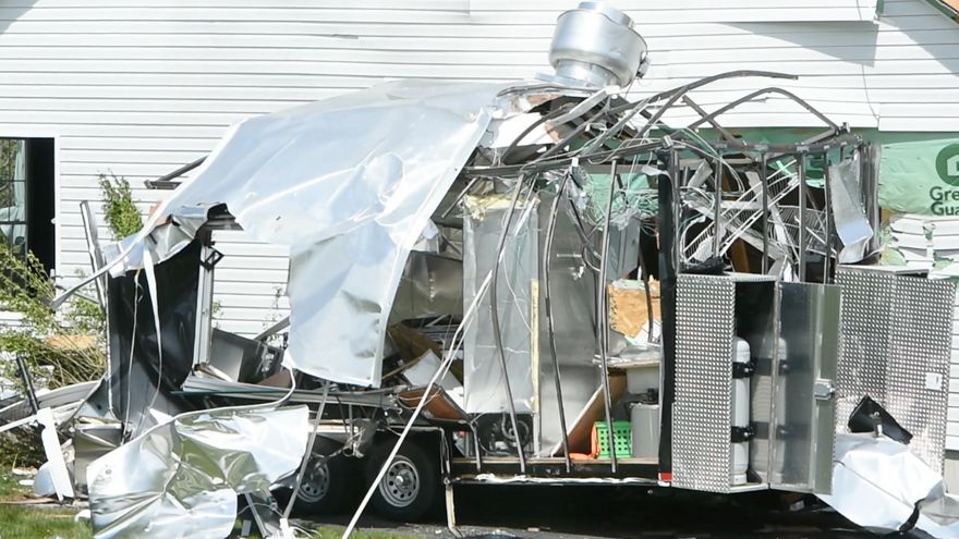

Home D will cut and thread any size pipe for you. When I built food service trailers we ran black pipe for most of the way and adapted to copper tubing to finish. We also ran the pipe inside the trailers, pretty was not an option. I know people do it but be aware that running the gas line under the trailer it is exposed and wide open to debris and corrosion. I personally would never use a 5 gallon tank on a small trailer. The trailer is rocking and rolling down the road and fittings come loose.

greygoos wrote:Home D will cut and thread any size pipe for you. When I built food service trailers we ran black pipe for most of the way and adapted to copper tubing to finish. We also ran the pipe inside the trailers, pretty was not an option. I know people do it but be aware that running the gas line under the trailer it is exposed and wide open to debris and corrosion. I personally would never use a 5 gallon tank on a small trailer. The trailer is rocking and rolling down the road and fittings come loose.
Debris big enough to destroy a 1/2" schedule 40 pipe has probably already destroyed your trailer, corrosion? if you plan on living and using your trailer a couple hundred years...maybe.
