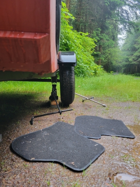

Hello all. I built a Wyoming Woodie in 2020 and have been camping, mostly boondocking, since then. This last trip I noticed the axle was slightly bent. This isn't a big surprise. It's built on the NT 5x8 trailer so the axle is pretty light to begin with, and I used 1" wheel spacers so I could get 175/80R13 tires on. I don't need real off-road capability, just forest roads, but obviously I've covered enough miles on bumpy unpaved roads around here to need a better axle. What would you recommend as a moderate upgrade? I can install a replacement 2000-lb axle, but 72" wide so no spacers, or I could go to a 3500-lb axle, but this seems like it might be overkill. The drop does take quite a pounding on those forest roads, even at slow speeds. A bunch of nuts fell off my new Camp Chef stove on the drive to the first campsite last weekend. I carry anything heavy, like water, in the back of the car because the drop bounces like a ping pong ball, although maybe a bit more weight might actually help.
My trailer weighs 275 pounds, and I doubt I've added more than 200 pounds in the shell, and I only carry camping gear, so not a lot of weight. Maybe 500 pounds total. I would love to use something like Timbren but it looks like you can't get those for less than $700, and that's out of my budget.
Any suggestions?

It's bent right at the inside of the hub, on the left side. Definitely wasn't that way before.
There's no indication the springs are bottoming out, though.

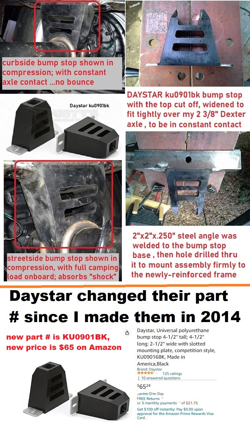

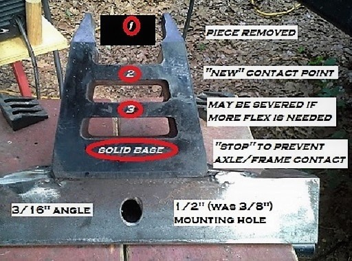

I had broken some springs on my car hauler trailer previously, so I fabricated what I call "progressive, active bump stops", that are bolted in place between axle and frame, always in contact so all spring action is absorbed (and the springs will never fold inward, and break). If the ride had been too firm, I could've cut a central ligament of each bumpstop to soften the ride, but it wasn't neccessary. They've worked fin for 8+ years, now.
Active suspension Daystar bumpstops.jpg (457.3 KiB) Viewed 3451 times
how it works (theory).jpg (125.08 KiB) Viewed 3451 times
