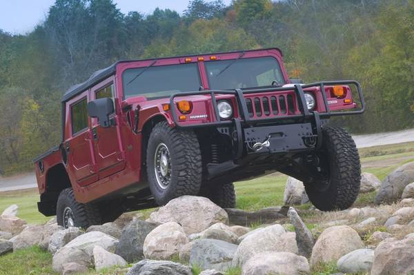

You show a pic of a H1 at almost full flex that's clearing a maybe 12" rock, and suggest that independent suspension is better than a solid axle leaf spring? I suggest you do take that discussion to a dedicated offroad discussion forum, such as [url]Pirate4x4.com[/url] and let me know where the thread is.

Notice the H1 has a driver !!!!! Notice the H1 is moving!!!! Hitting an obstical and is still level. And by the way. If you have ever driven an H1 in the field ( Army reserves) that is no were near full flex (look at the rear suspension).But it is a pig compared to a TJ. And also notice the only rig that you list that has leafs is the (fabled) 1996 yj and it has lower nuimbers. And is probably a quarter the weight of an H1. If it had ever ben built. (it was not ) This is in the relm of Jeep lore. A diferent topic all together....
