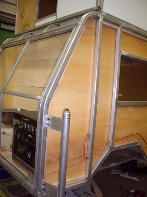

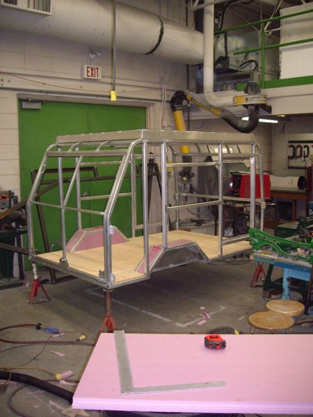

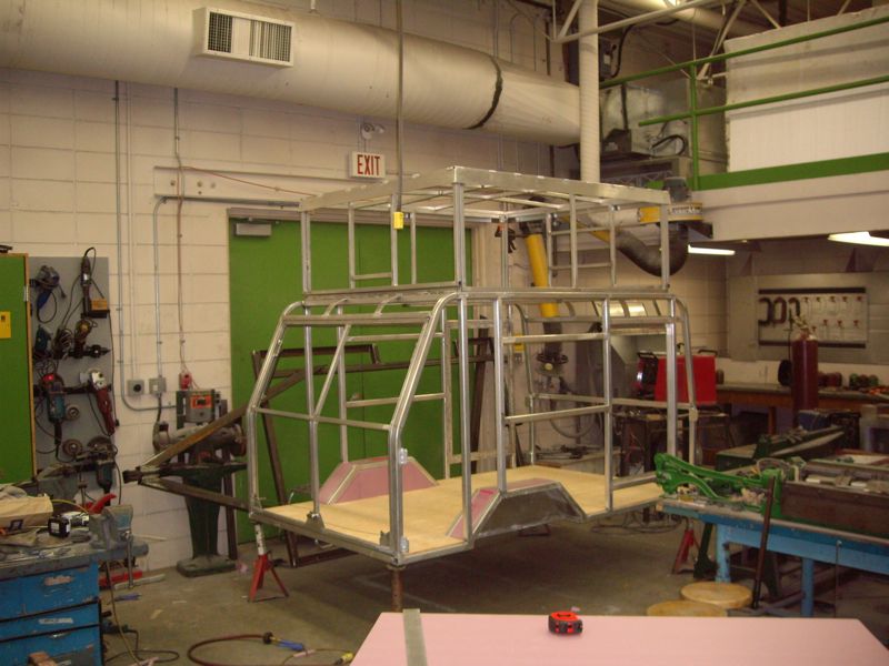

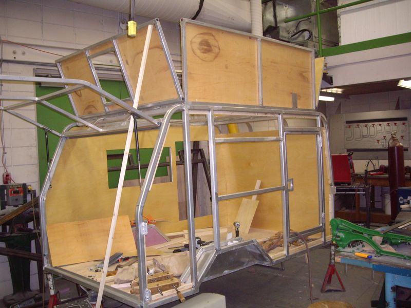

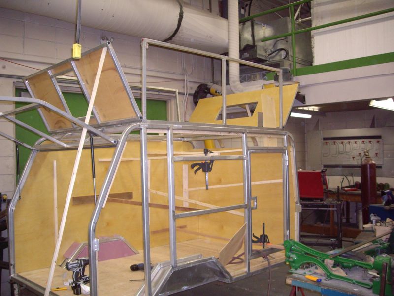

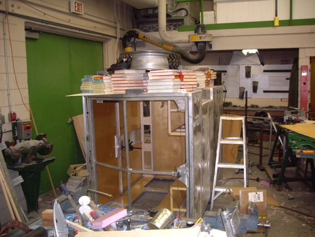

Well I hope I am finished the welding because I have started covering the thing!
Here are a couple of pictures showing where I am at now.
Here is the pop up and roof down:
And here is the pop up and roof up.
I have insulated the floor with 1 1/2 foam and covered it with 1/2' fir plywood. (glued and screwed)
I have been planning out the interior layout and I hope to start on that and the interior skin soon. You can see the trailer frame in the background as well as my messy shop!

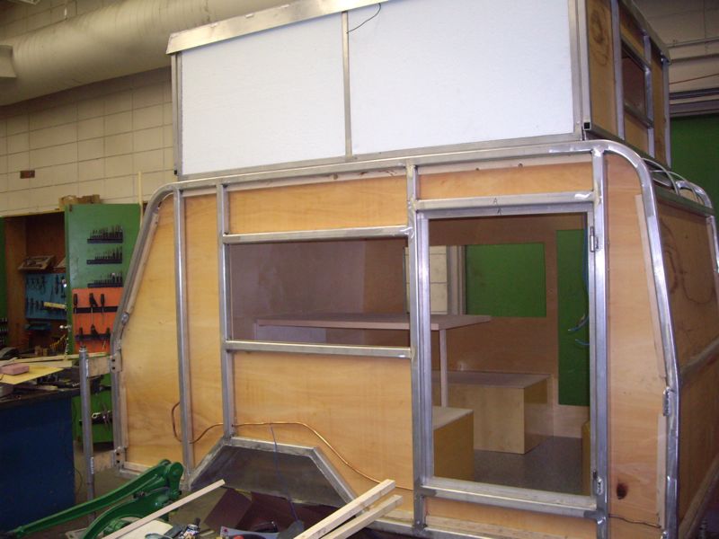

Putting the first panels on.
I glued them with construction adhesive screws will be added later for window trim and whatnot.
Cross bracing till the glue dries overnight.
Window and door cutout.
Getting a little extra help!
The loft area.
Testing out the benches.
More updates to come soon. I am trying to get this thing done for trip down the coast(Vancouver Island to California) for this summer!

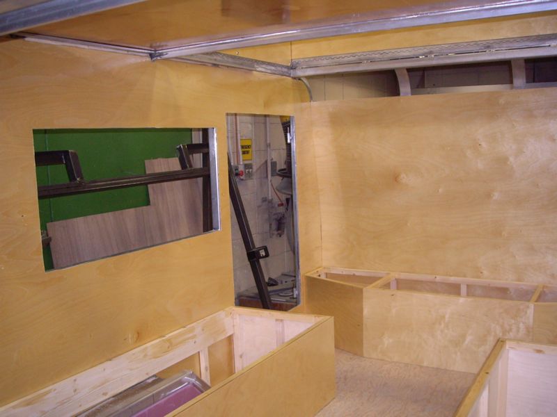

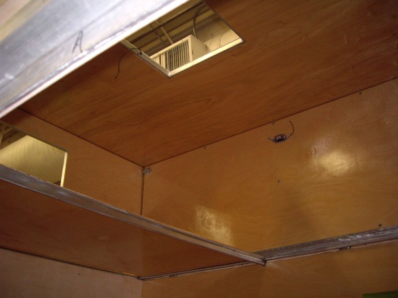

Here is a picture on the inside looking up:
I have mocked up the table and I am fairly happy with it.
The front support is a scrap that will be replaced so no fear on it being out of plumb and all that.
The table has as its rear support a hinged section that extends to form the rear section of bed. Kind of hard to explain but it works!

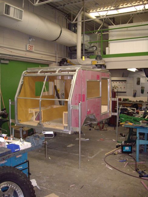

I am flying along. All of the wiring is done so that I could start covering the exterior.

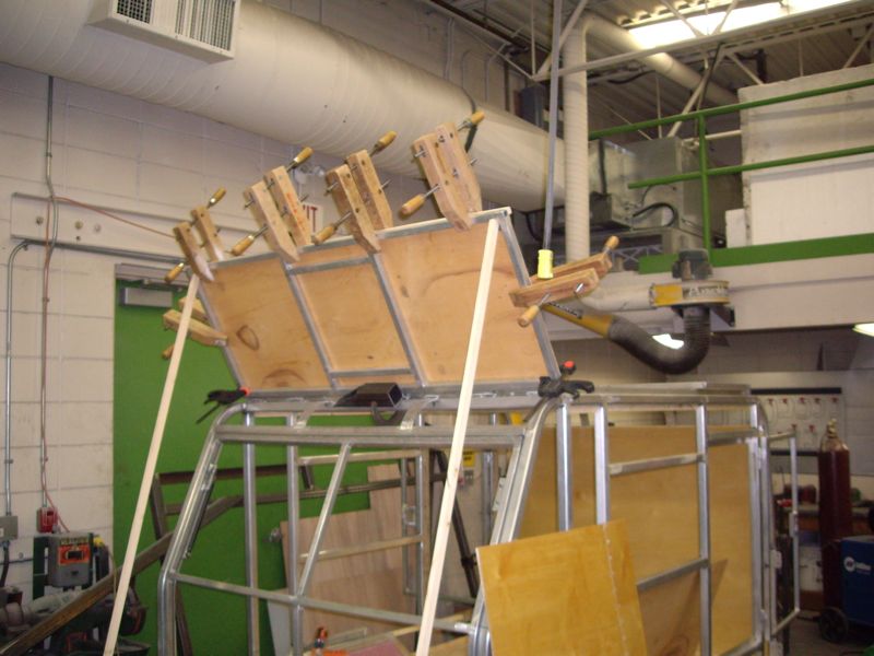

All of the upper exterior walls are covered with FRP now and I am finished the two lower sides as well.
I flipped the trailer over on its side to do the two sides to get gravity working with me. I added whatever I had handy to the top to get it as flat as possible. Here are a couple pictures:
You can see I have got a real good mess going on at this point! if you can believe it I still plan on being finished for July 2. We will see.
These jacks that I made really helped facilitate actually getting it down.
The flipping it over was fairly easy it is not as heavy as I thought it was although I have stripped most of the cabinet work to put the finish on it all
